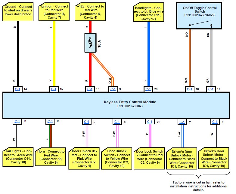

    Thanks everyone who has contributed here. I've got my kit in hand, and ready to install but want to dial in my understanding of the ON-OFF toggle switch. The OEM guide goes through the process of using this switch and the ignition switch to teach your receiver your key fobs, but doesn't cover whether or not to leave it in the ON or OFF position when done. The OP states to leave it in the ON position, but others through this thread have said to leave it OFF.
    What does turning the valet switch in the ON vs OFF position actually do, and how are y'all leaving it when you're done installing and putting things back together. Thanks!

    OFF - that’s the last place left it per the instructions. I tested both my FOBs before mounting the box, already programmed didn’t need to program them and didn’t install the switch. likely for if you have to buy a new FOB for it. Switch is only used to allow the box to be in the programming mode.

    It could, the install would be very similar. You'll need to identify connectors in you 2nd Gen that have the required circuits to tap into. Ground, Fused battery power and fused ignition source are easy. The unlock detect wire, unlock/lock switch wires and the unlock/lock solenoid on driver's side.
