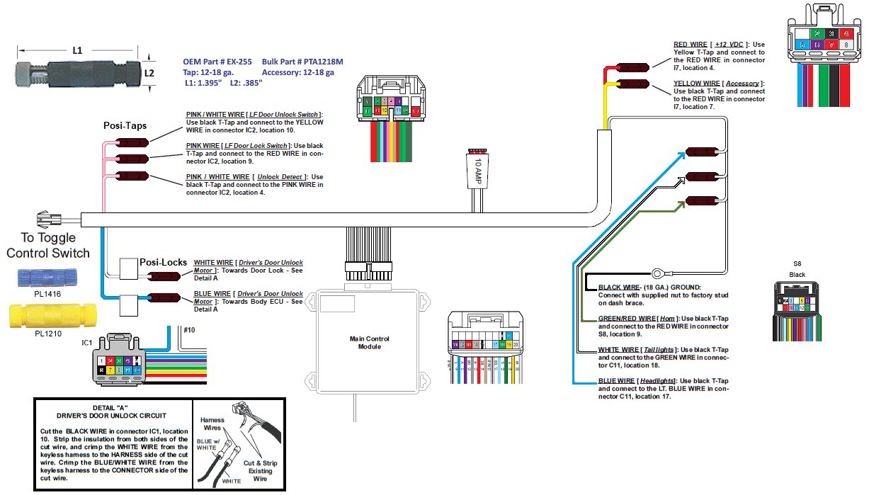

    Thanks Tyler! I installed this today and your post made it significantly easier to follow the steps and identify the correct plugs in really good detail. I’d recommend anyone doing it not comfortable wiring or without experience take it slow & treat the wires gently. It’s delicate work, try to accomplish something different if you’ve got a couple beers in your system. Thanks again!
    additional notes; installed the bed lights at same time, the two towards the back not included in my package. The harness & relay were already installed on the base model, was easy to just pop in the oem switch at the same time then plug in the lights behind the taillights.

    Hi guys and gals. I have had my kit since last fall and finally got around to installing it. Don't care for the wire splicing on 22-24 ga wire but I did it and hope those little tiny wires hold up. Mine weren't exactly all under the column some were more to the side but there is room in the bottom steering cover for them anyway and I don't think they are under any stress under there. So cheers to the people that have done it. My install worked the first time I tried it with both remotes.

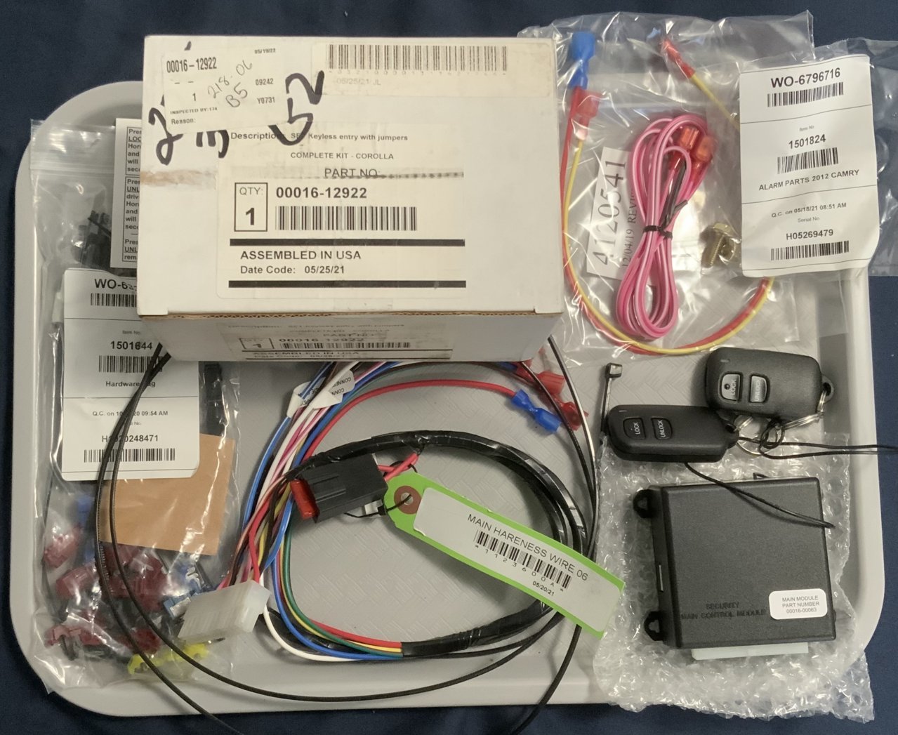

    I had to sign up just to say THANK YOU to the OP Tyler for the great pix and advice! The instructions that were not included but in the link you provided were a bit confusing but between that and what you posted and the great close up photos you had I did it no worries. It was difficult to find one of these kits as the part numbers are confusing and don’t exactly match on all the documentation and posts here. None available on Amazon in 2022 but I got mine from an eBay dude who had several left as of about a month ago. (April 2022)

    New 2023 SR taco owner here and 1st post. I thought I missed the boat on getting an OEM keyless entry kit but I did managed to find one (00016-12922) in Buford, Georgia after three weeks cold calling taco dealerships throughout the southeast. It didn’t come with instructions but thank goodness for this thread and the PDF instructions from Sparks. When I ordered one, the parts manager told me it’s been discontinued but had 3 left in stock in their Florida warehouse if you’re interested.
    A million thanks to @motofish84 and all other contributors for this guide. After reading many helpful threads, I wanted keyless entry without remote-start. Coming from a Subaru Forester, I thought you just needed to buy a fob and program it to get keyless entry. Boy was I wrong. I’m going to replace the T-taps with Posi-taps. Hope it works.

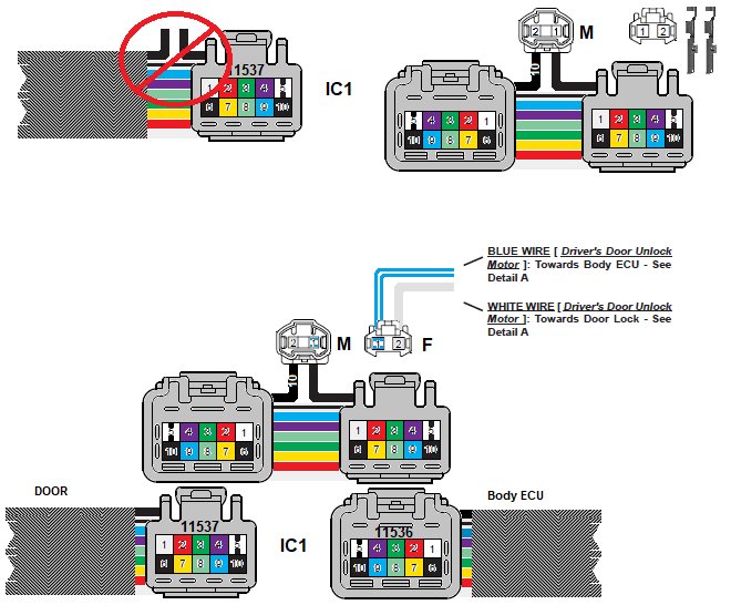

    Complete over built:
  14. Apr 7, 2023 at 2:28 PM
    #114
    caribe makaira
    caribe makaira Well-Known Member
    Feb 13, 2011
    #51121
    11,816
    Caribbean, Puerto Rico
    05 PreRunner TRD Offroad AutoTrans
    Hood Struts, My version Fogs always ON, Map & Overhead Light Mod,

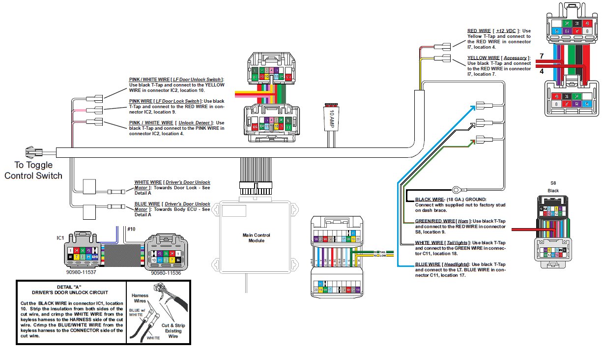

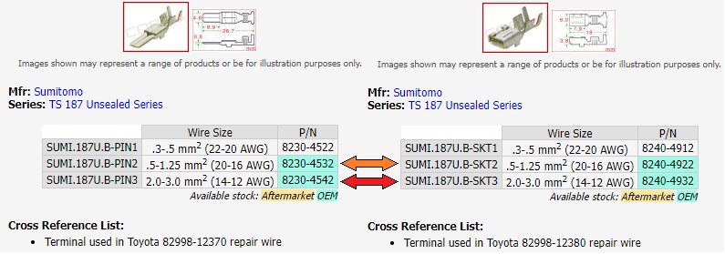

    Snip them 3M taps and replace with Posi-taps:

    Wow, a million thanks, @caribe makaira. I really appreciate all of the diagrams.
