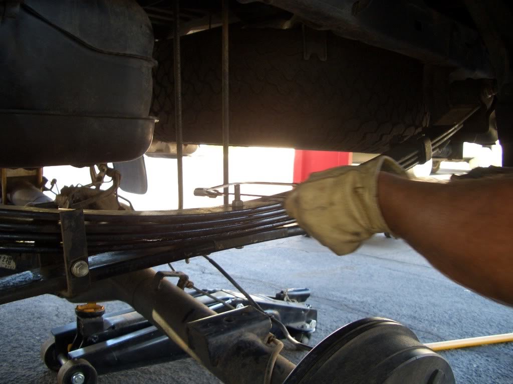

    Do I need to use the c-clamp since I'm removing the entire leaf pack? Wouldn't I be losening up the ends where the springs attach to truck as seen in this photo on the far right?

    Thats right, but I still used the c-clamp and then slowly released it once I had the center nut off. Just in case there was some built up pressure. Make sure the rear axle is dropped far enough and the leafs are completely neutral, otherwise the full leafs will be pretty hard to get out. I went through an ordeal with my back leafs during install, but I got it sorted.
