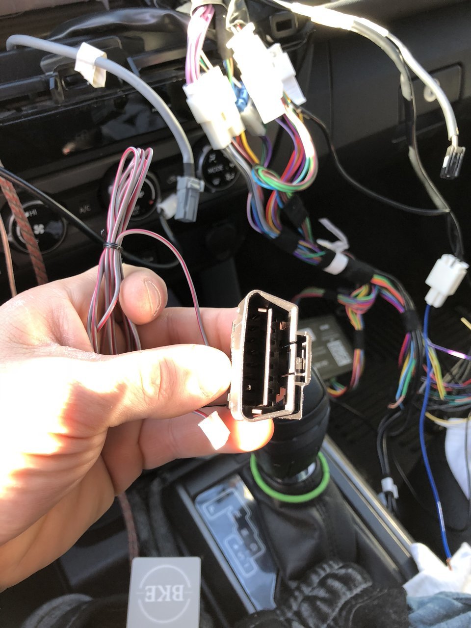

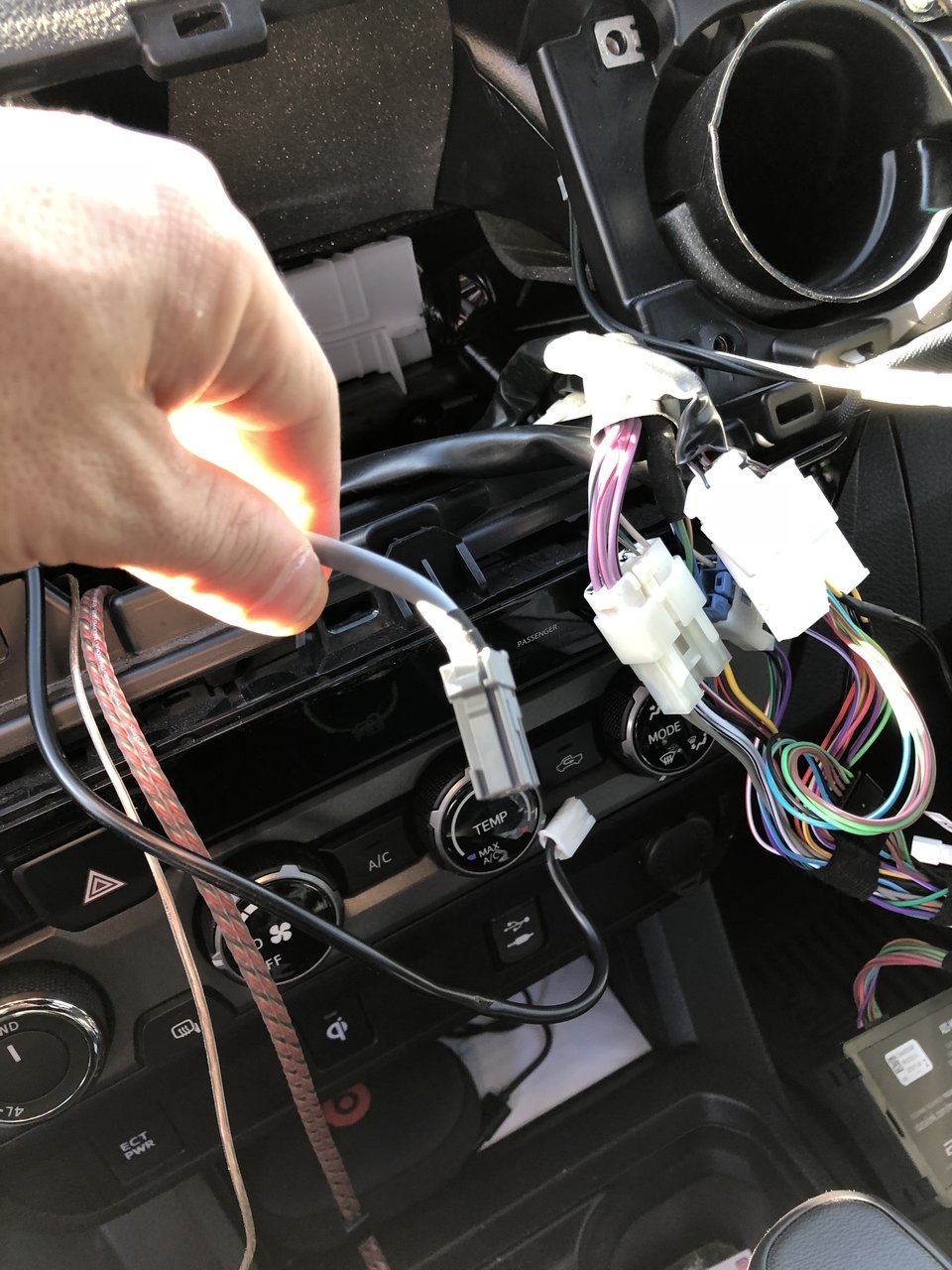

    Ok so I have it all but installed, gps works, radio works but my backup camera isn’t kicking on when I go into reverse. I have just a couple plus that don’t have a home so gonna post them here for help.
    1) this blue wire comes off my antenna adapter cord. The small factory plug next to it I feel like is probably where this goes but I didn’t wanna start splicing without asking. I assume it’s for satellite radio.

    2) the next open plug is a factory plug and I can’t seem to find anything that would plug into it. I bought all the necessary harnesses to make this install proper.

    3) and lastly this adapter came with my t02 harness but I don’t have any factory harnesses left for it to plug I to. It says it goes to obdII connector?!

    #200122
    542
    Maybe it's for reading your engine so that it can display cool stuff like the rpm and air fuel turbo afe ratio

    The obdii connects through the radio harnesses in our trucks. It is included for other vehicles where that is not the case and needs a direct connect. I trashed mine.
    You do get obdii info on the radio screens ? Tire pressure to each wheel, door open, engine specs etc ?
    Don't forget 12v power to the fin antenna. It's not on the diagrams from what I remember. It's for the ant preamp. Low signal otherwise. I think it's the blue wire, will have to check.
    There is a setting in the radio for backup cam to enable. I had same issue, didn't work.
    Also in the radio settings allow multiple obdii connections. Scan gage ii and other things won't wont allow the radio to get obdii info otherwise if plugged into the main obdii. That drove me crazy until I found out.
    Doesn't the gray plug go to maestro module ? I'll look at my notes when I get home.

    Ok so i found the obdII connector and ran it to my wiring harness. I’m gonna guess this helps feed the trucks performance back to the radio.
    But my backup cam still doesn’t work!

    Run the obd plug to your obd and it’ll give you gauges and some other car info. It’s optional, it won’t hurt not to install it. The other plugs I’m not sure about.

    You shouldn't need to do that. It's factory wired directly to the radio already. No need to jam up the main obdii connector. I didn't need it.

    Either it's a setting that MUST be changed in radio pages or reverse line wiring.
