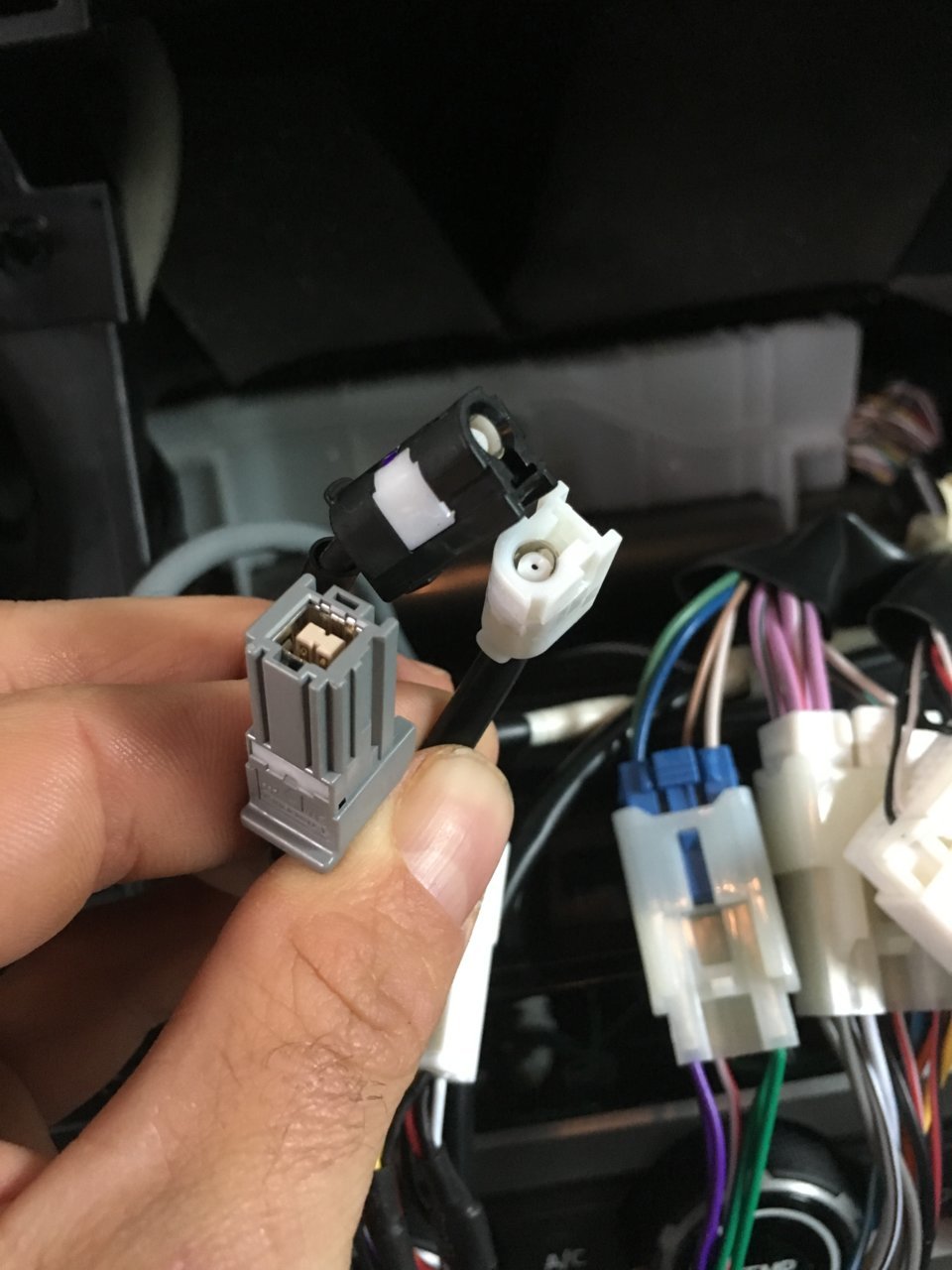

    For those that have installed the 8200nex, I’m putting mine in today and everything seems to Ben working fine but my OEM microphone isn’t not working. I really don’t want to use the included external mic. Any suggestions?
    ETA
    I also have these three factory wires with no apparent place to plug them in. Any ideas where they go or if ta related to my mic?

    You can't use factory mic. Those plugs are factory gray-USB, Black-SAT Radio, White-GPS. All those plug into back of Head unit with a wire adaptor kit
    These should be what you need, but ask crutchfield and they will help. It shows the 8400 but it should be same as 8200 as far as the parts needed.
    https://www.crutchfield.com/p_1308400NEX/Pioneer-AVIC-W8400NEX.html
