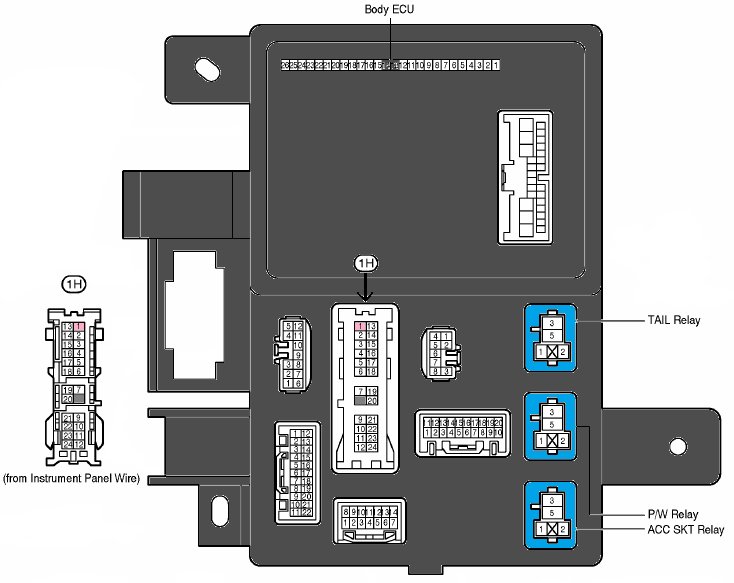

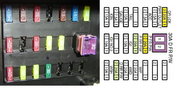

    Does the vehicle have all the fuses installed in the cab fuse box/BECU?

    I bench tested mirrors and window motor operation and they work awesome! Just need to get the locks working and tear the dash apart to figure out how to make the wiring harness.
    Thanks everyone for all the wiring help. :thumbsup:

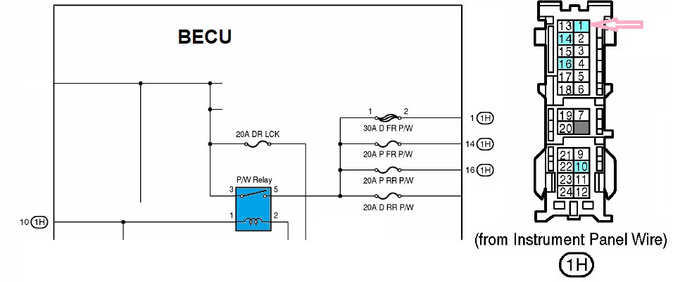

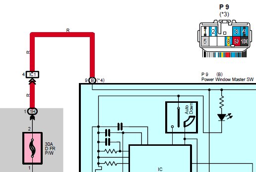

    Driver's side power window fuse(LP_JCase) at 1H_1.

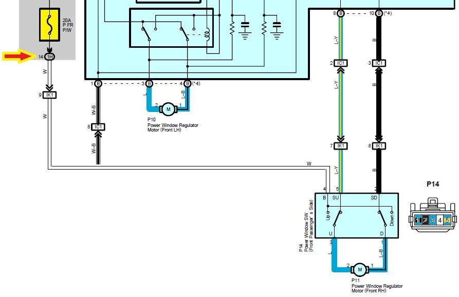

    Passenger side power window fuse at 1H_14.
    Jody hernandez[OP] likes this.
