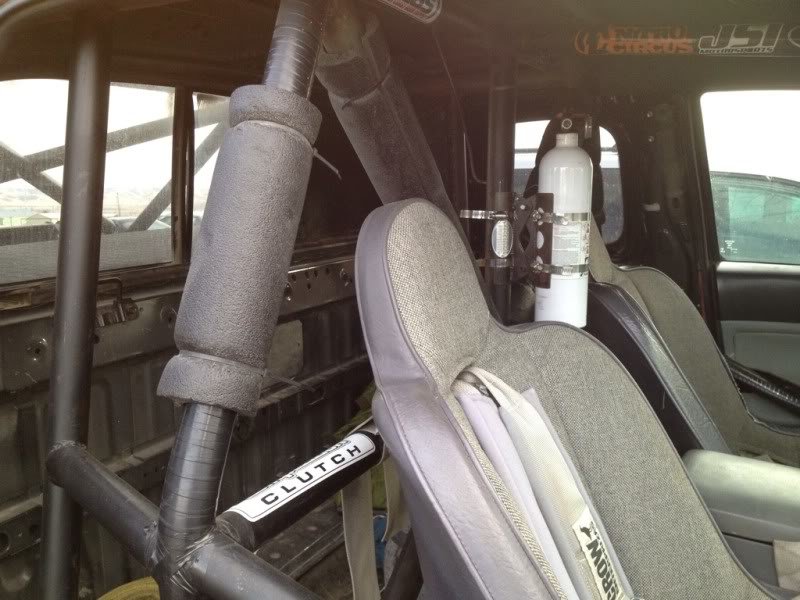

    You can cut the modules out of the factory seats and install them in the other seats if it's that big of a deal to you. Personally, I just cut all the wires and disabled them, then pulled the gauge pod apart and painted over the idiot light. I also have 5 points and a full cage so airbags won't do anything for me anyway.
