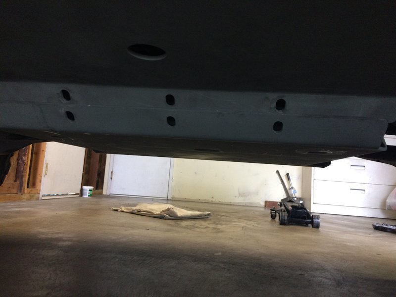

    I was able to install my IFS plate but when I installed my mid skid it came short and can not align with the screw holes. Any ideas on how to fix this? Skids are pelfreybuilt.

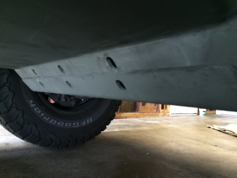

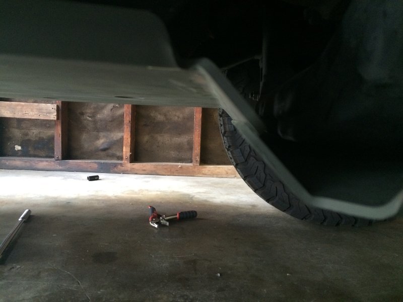

    I tried every variation possible. Loosen everything to get as much play as possible and the pictures show best results. Close but no cigar yet.
    Any one has a skid stretcher they can let me borrow?

    Looks like your IFS plate is hanging kinda low in the back end where it meets the other plate. Can you see if you can loosen up all the bolts a lttle and place a jack in there and lift it some more?

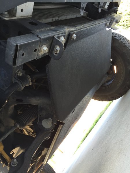

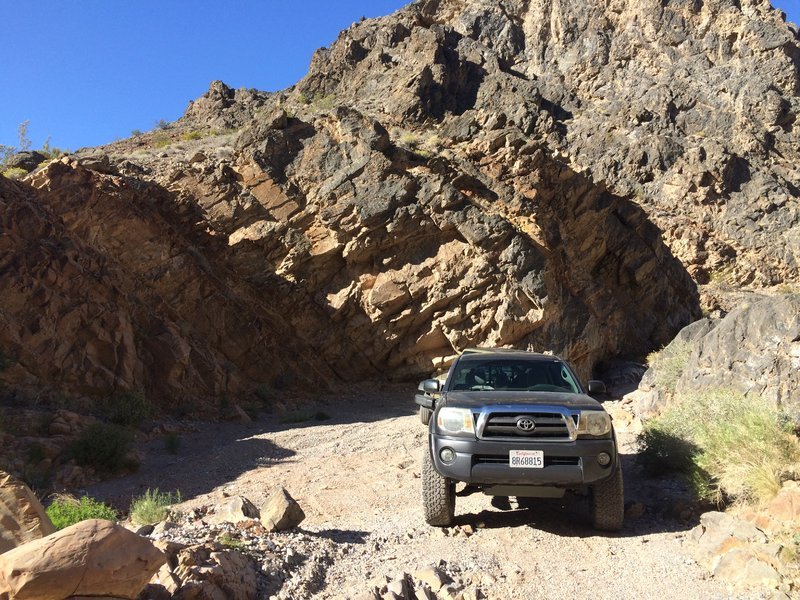

    Check me out this last weekend at death valley going down Steele Canyon steps on my way to Eureka Dunes.... That's a sexy Pelfreybilt IFS skid...

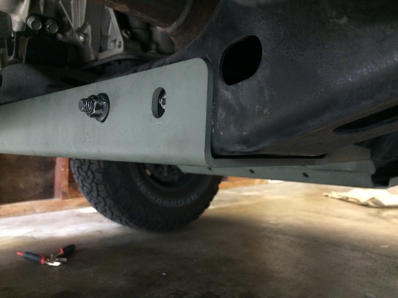

    BUT, I have an idea, looking at the pictures below, a connecting plate could be overlaid on to both plates and attached with screws. I could also maybe make the IFS plate mounting holes bigger to maybe push the IFS back like 1/4 and that would work too. And last but not least,,, if anyone has a IFS skid stretcher please let me borrow it :fingerscrossed::crazy:.

    Hey Ceasar, Sorry, the skids don’t work on the Pre-runners, the two skids are slightly farther apart because of the cross-member location. I can make an adapter for you to make it work since you already have the skids. Emailed you about this as well, please let me know how you would like to proceed. We will get you dialed in one way or another
