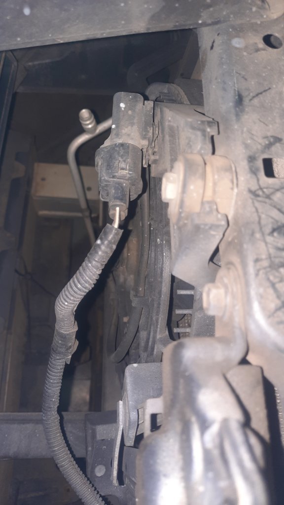

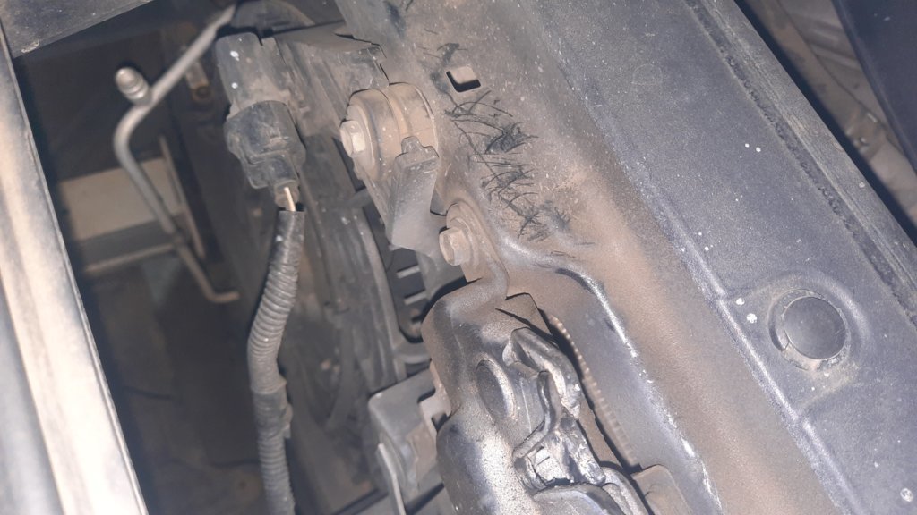

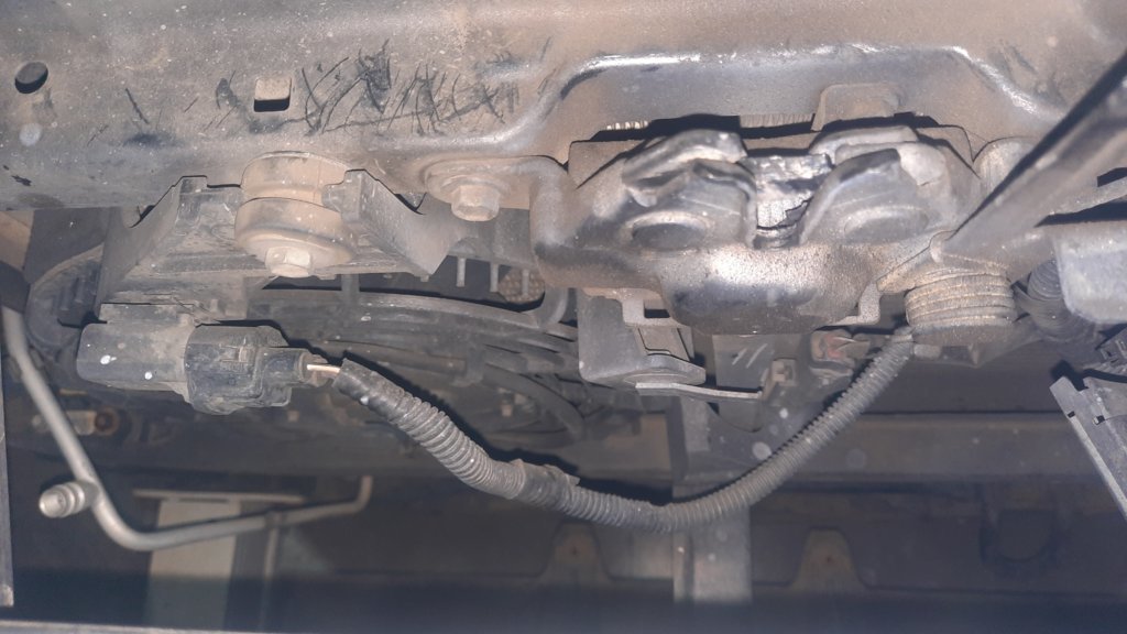

    20250314_062511.jpg 20250314_062302.jpg 20250314_062503.jpg Here's some pictures of my fan. The best I could do.
