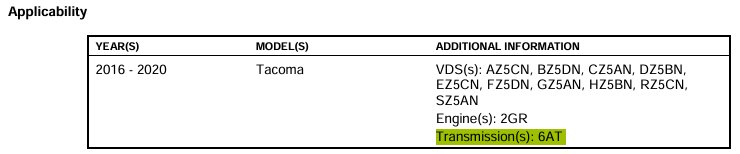

    For the wiring, I’m not sure I understand. The TSB I look at shows going to pin 16, connector 1F. Where are you seeing it says to use pin 32?
    For my truck, I had to keep the wire I spliced into intact because it fed other circuits, I think the clutch start circuit and some other stuff. I don’t recall but I know I looked into it and the wire I spliced into, I definitely had to keep intact.
    I do vaguely recall deviating from the TSB but now that I look at the TSB, I can’t see why or what I would have deviated from.

    Sorry, that was a typo. Pin 16, not 32. In your write-up, it looked like you left the original wire and your new wire connected. In TSB, they leave the original wire disconnected.
    82112–04050 wire, engine room no. 2. It’s listed in the TSB. Not trying to be a dick, but if you suck at wiring, you may want to ask a friend for help. Even with the harness, there’s still splicing and adding a pin into a crowded connector.

    I just went through the diagram again and reminded myself of why. On every part of the diagram where 1F pin 16 is mentioned, it is referred to as (M/T), so it must be a manual only thing. According to the diagram it only feeds the cruise control clutch switch (top of the pedal, disables cruise with pedal press), and so it's definitely necessary on mine. It is just a simple 7.5A ignition circuit.
    No idea why they would tell you to snip the wire and tape it off if the wire is there, this TSB must officially be for automatic transmissions only or something. Between that and the relay box that needs to go where the clutch reservoir goes, a technician that goes strictly by the book would be dumbfounded trying to install this on most MTs.
    So I guess they assume all trucks getting this TSB are automatic, and if the wire is there, great, still not needed, but if it's not there, then you insert the pin. For me it was there AND needed, so I spliced into it.
    Bottom line, if the wire is there already, then it can't possibly hurt to keep it spliced together, and if you have an automatic then snipping it and folding over the unused end will work fine too.
    Edit: Looks like the TSB is indeed only officially supported for automatic transmissions and the V6. So that is why the instructions would say what they say.
