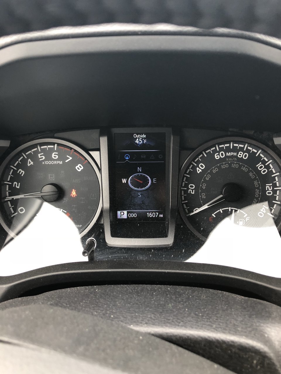

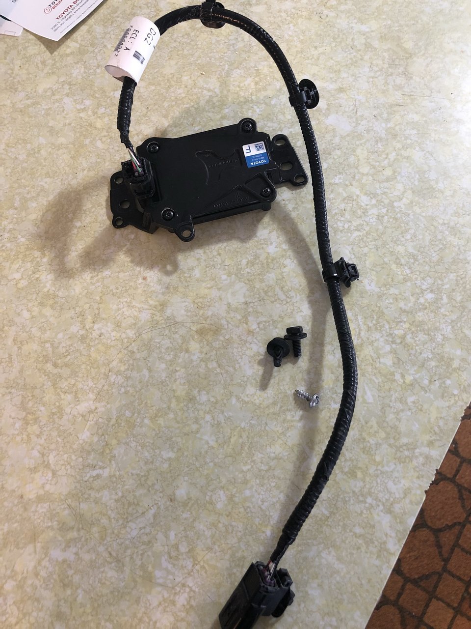

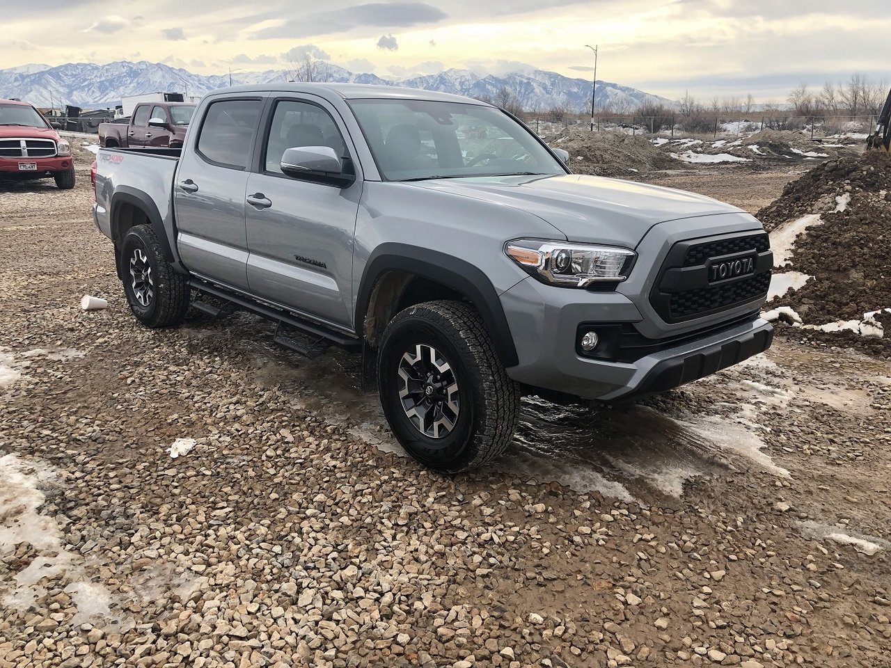

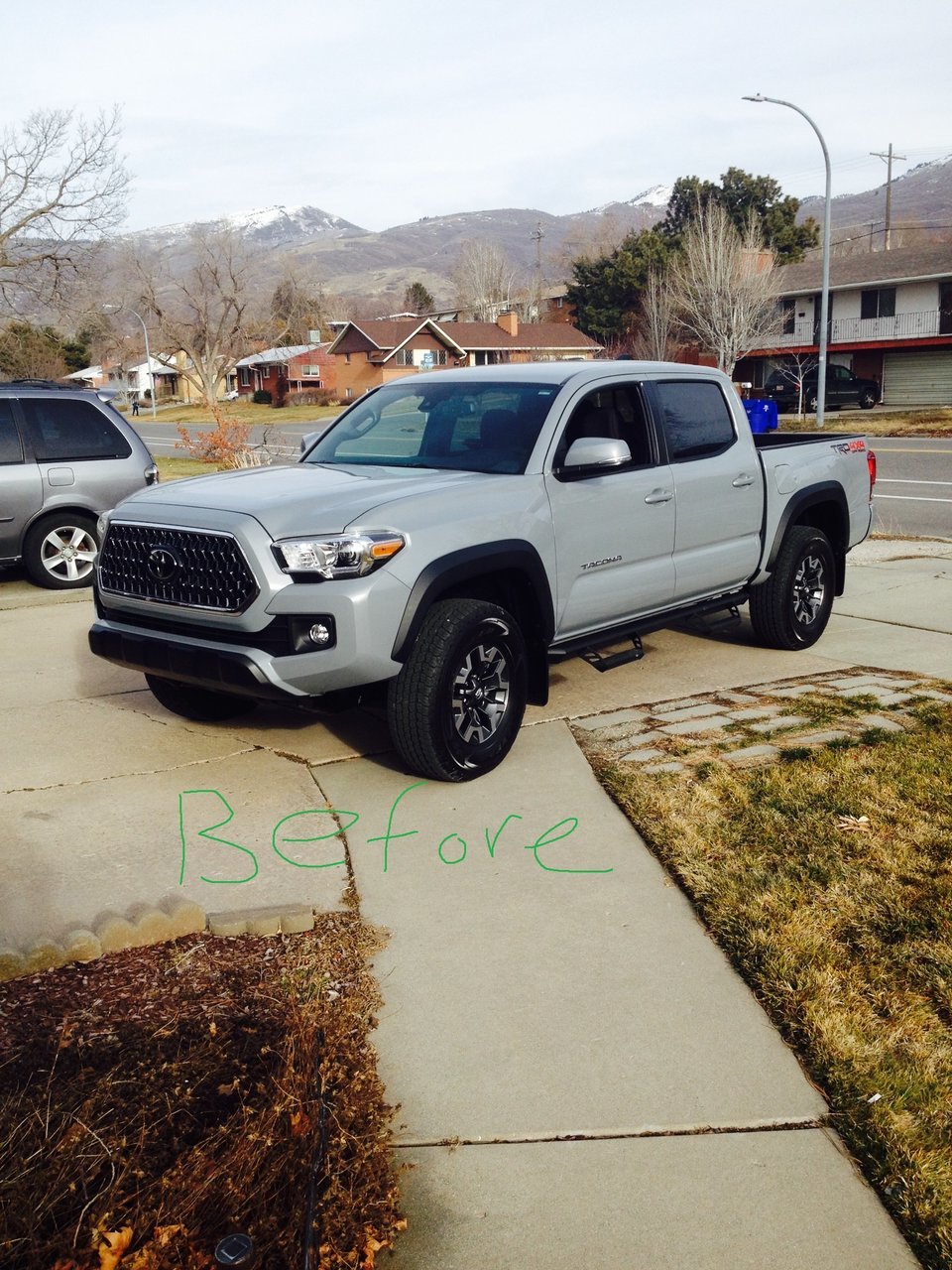

    I have created this thread for everyone out there wondering if they can still use their TSS sensor on a new 2018 TRD Pro Grille and the answer yes, I own a 2018 TRD OR and took off the stock sensor and installed it on my new OEM TRD Pro Grille, everything works perfectly i test drove it many times and now i know you don't need to recalibrate it, so those of you who are wondering about buying the new grille, just do it!

    What does the front of the actual radar unit look like? I've only seen pics of the backside with the connector.
