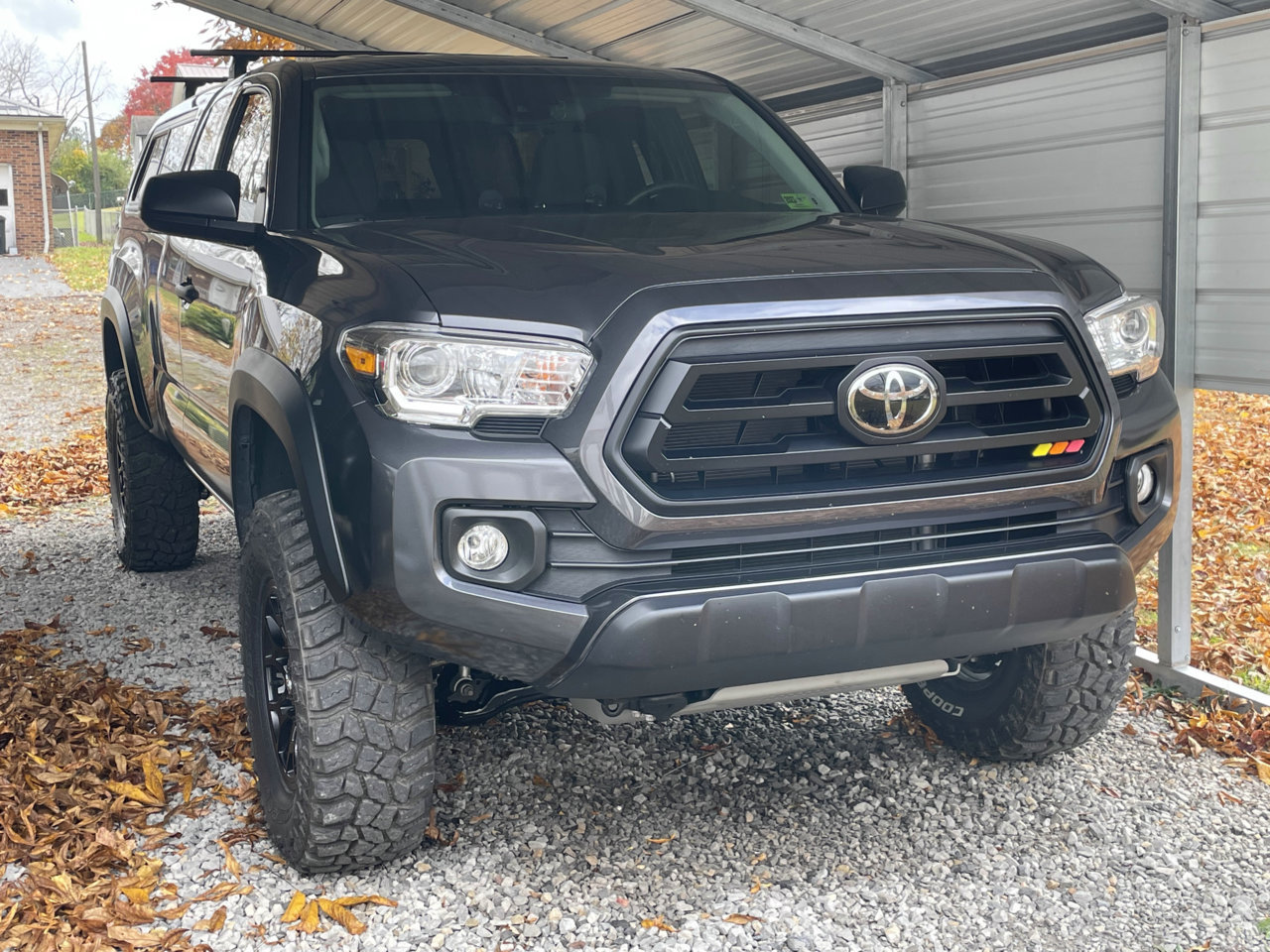

    No problems other than a somewhat messy oil change due to residual oil splash on plate. The plastic air dam is begging to get ripped off anyway.

    Thank you. N22WLZ that looks good without the air dam...totally agree with "begging to get ripped off" by the way it hangs down there.
