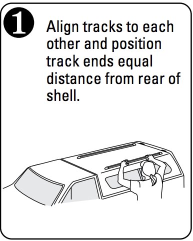

    Just looked at those instructions and I only see to measure same distance from rear of shell.
    Where does it say to run them parallel?

    It says "align tracks to each and position track ends equal distance from rear of shell." Align tracks, as in, make them parallel.
    And if you get too much of a misalignment (out of parallel), your feet aren't going to allow the cross bar to align either. Everything has to be "square" or it won't work.
