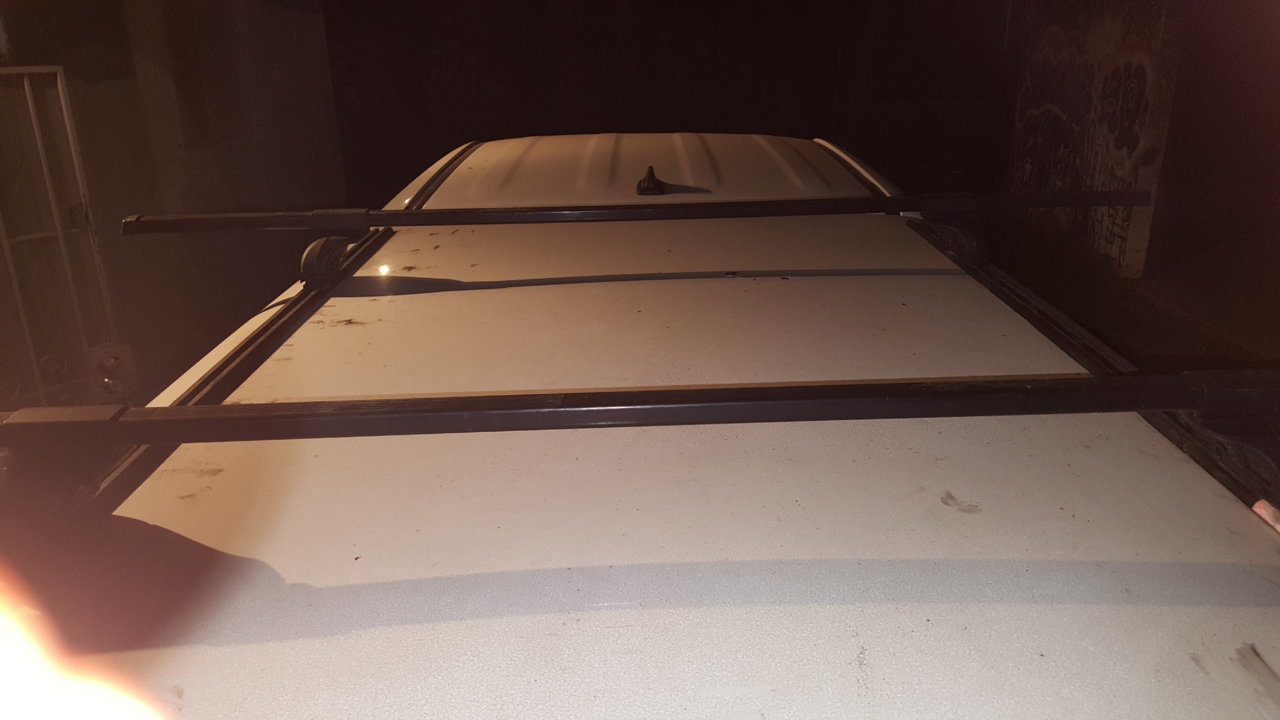

    Meh, mine work fine and look good as they follow the tapering of the truck topper. 1.37" over 5 feet isn't much variation. That instructions are ambiguous and one way to read it is that they should be parallel, another way is that they are saying they should be equal distance from the end of the shell, that's all.

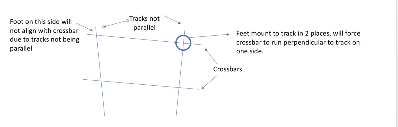

    The distance between the tracks at the front is wider than the rear by 2.75"? I have no idea how your bars would ever work then. I have Thule Tracker II's with square bars, the tracks are perfectly parallel with each other. Here is an "extreme" diagram to show how it won't work unless they are parallel.

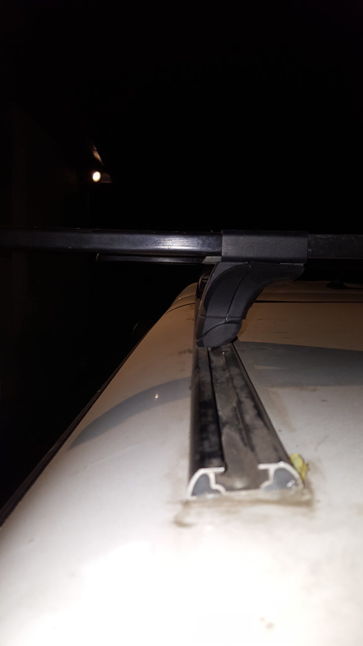

    The tracks should be parallel. And "meh, mine work fine" doesn't mean it is right, just that yours has enough slop in the tolerances to work. Did you install them, or did they come on the shell already?

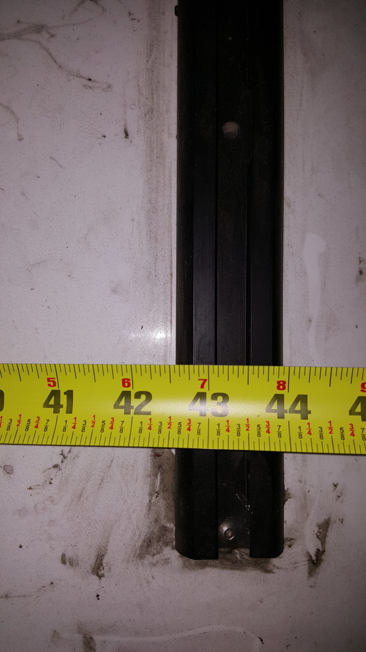

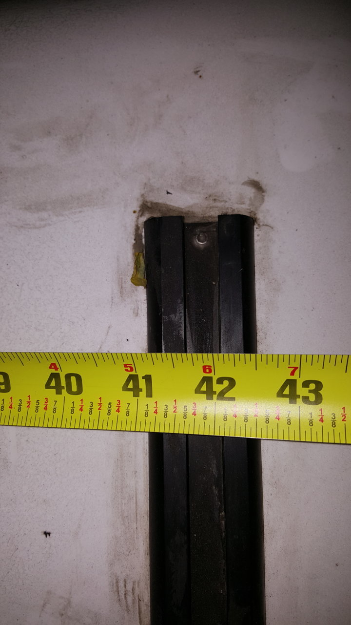

    Where are you measuring that shows them to be 2.75" closer together at the back? Track to track, or from the edge of the shell to the edge of track?

    I was wrong, i just remeasured from outside edge of tracks, front and rear, looks to be a little less difference that I thought, around 1.5" I self installed. Found the tracks in the spare parts dept on ORSDIRECT for 20$. They look good as they maintain an equal distance from the shell where it turns down.

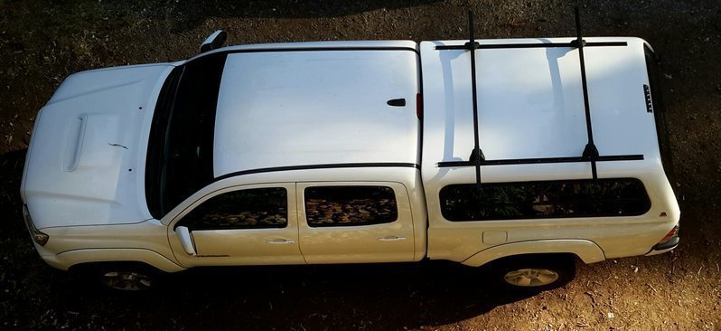

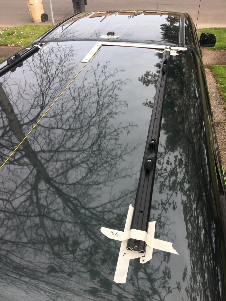

    I think its your preference on whether to taper the tracks or not. I installed mine parallel to the centerline of the shell. I think its best to keep everything square so not to torque the towers on the tracks when they are tightened down. Its easy to adjust the bar position on the tower to slide em.
    Heres a shot of how I did it. I suggest taping them down, squaring multiple times, marking the holes on top of the tape, and then drilling through the tape. Mine were 16.25" perpendicular from the centerline to the tracks. I ran a string from the antenna? to the brake light.
    If your going to swap out hardware(the supplied bolts were too short for mine), make sure the plates in the tracks can clear the new washers and bolt heads, and go with all the same metal, so they dont corrode each other. I made the mistake of mixing zinc with stainless. I think it will be ok... : P
