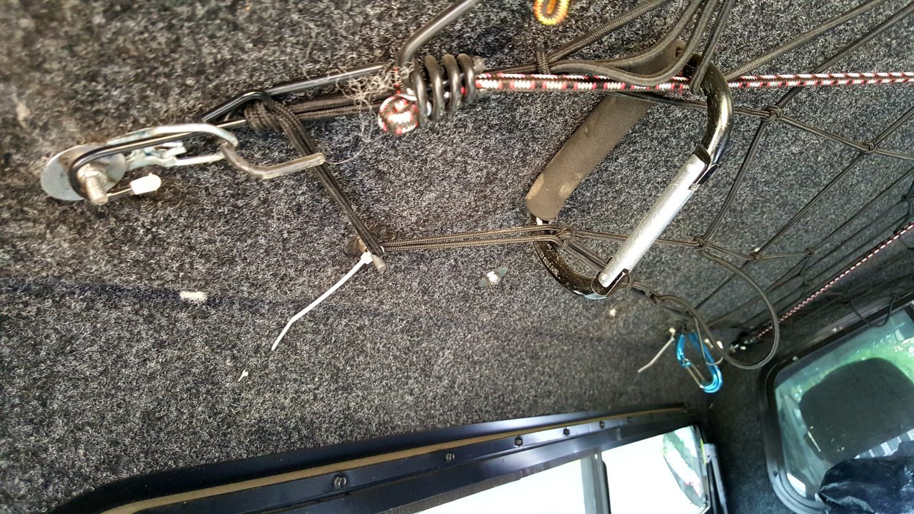

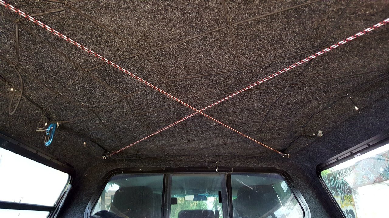

    Anyone put d rings on the inside of there's when installing? Have pics?

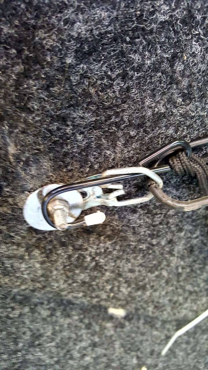

    Small picture frame hanging d-rings with a 10$ harbor freight net+ bungees, i stick my sleeping bag and pillows up there to keep them outta the way and dry out during the day. Also hang an led lantern, headlamp etc...

    Ya I was totally thinking about using them for hanging lights and other stuff not a net much because sagging lol

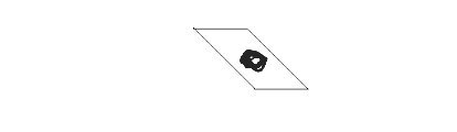

    The thule rack tower bases have nuts shaped like this, they rotate to grab the upper inside of the track when you tighten them.
    They lift up and out of the slot in the track if needed to move the bases. I have never needed to slide or move mine as the crossbars line up with my ski box, but i could see someone needing to for different applications.
