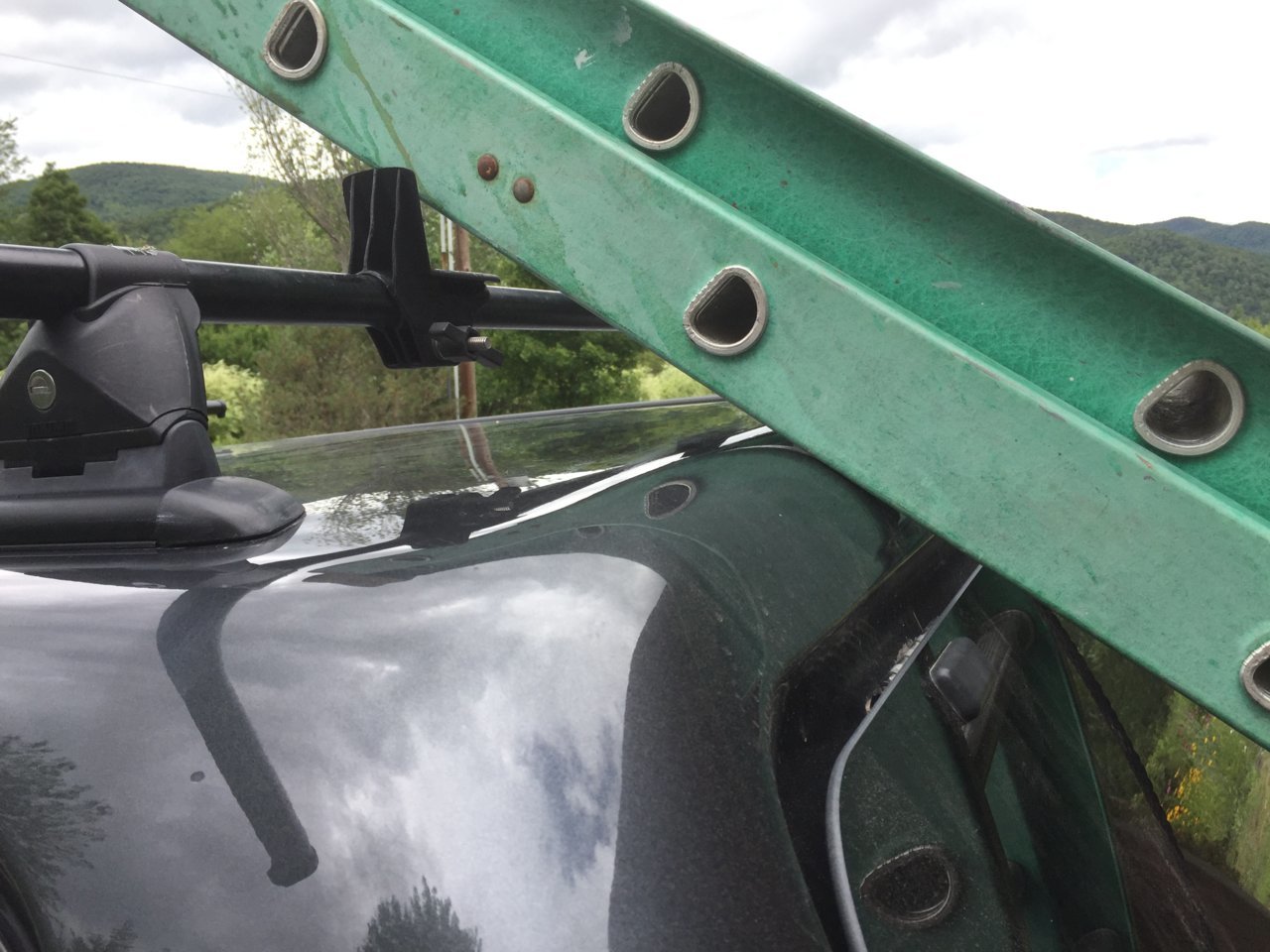

    My advice is to mount the tracks as far to the rear of the cap as possible. That way when you load something long you don't have to worry about hitting/scratching the top edge of the cap.
    In the picture,IMG_1462.jpg the (factory mounted) tracks could have been mounted a couple of inches further back and then I wouldn't have to pad the edge of the cap every time I load something long.
