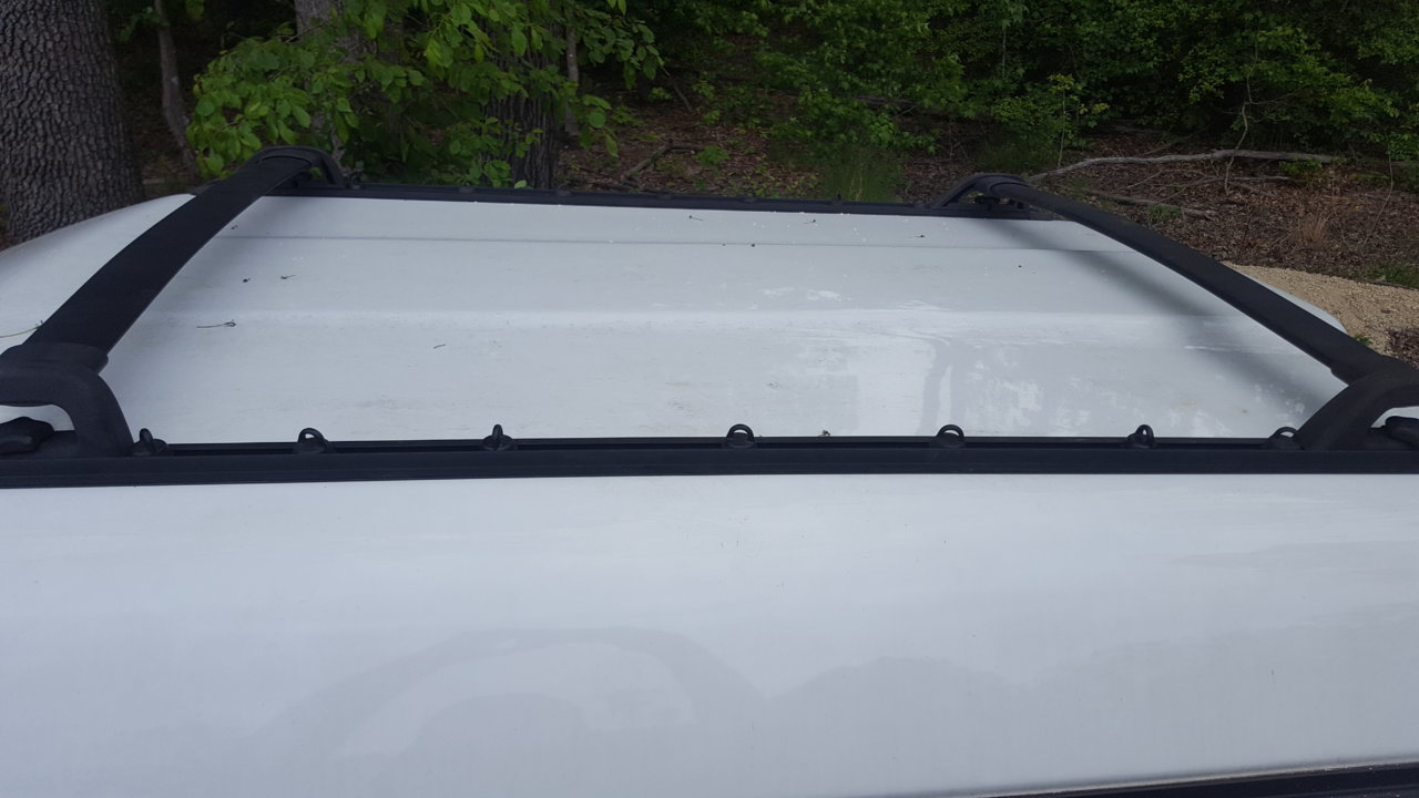

    If you all are looking for a budget friendly alternative to the more expensive brand name tracks like Yakima, Thule, Rhino-Rack (or even the more budget friendly - Proline), you could try doing what a couple other members did, mentioned on a similar themed thread entitled "Cap/shell roof rack". You might also find the thread "Cheap DIY Shell Roof Rack" helpful.
    Long of the short - you may have some luck finding some early 2000's Ford Windstar roof rack and tracks for around $20 at your local Pick-and-Pull/junkyard, which would work perfectly for a Long bed topper. And they are pretty low profile, imo.
    Or if you're looking for tracks for a Short bed topper, then late 90's/early 2000's Toyota 4Runner (I think they're 48"?) might work as well. And the 4Runner racks/tracks even come with some little I-loops that you can attacks hooks and things to, like @vwbuggsy did - here.
    Hope this helps! :thumbsup:
