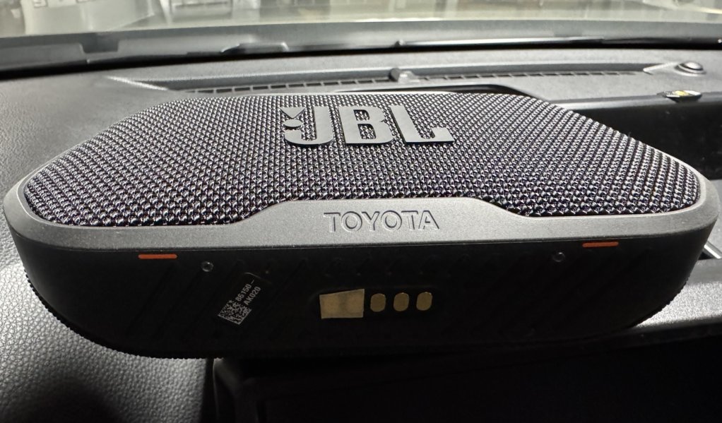

    I did some measuring and some trial and error and found that the two left-most contacts are the audio out. The center is common and the two right-most read 3.3V.
    So if you put tape over the two left-most contacts, I believe it will still charge but not contribute to the sound in the truck.

    Good info but that has already been determined & documented...
    Add some painters tape & its insta overall sound improvement....

    Oh sorry. I just saw the general “put tape on the contacts” comment but not the specific contacts so it would still charge.
