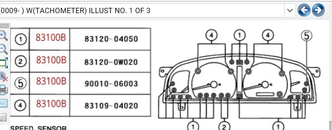

    I changed out the 4 (194) bulbs in the instrument cluster today.Ask me how much fun that was.:rofl: I've been trying to identify the other bulbs and finally found this. Does anyone know how to cross reference bulbs 1,2,5 for sylvania mini bulbs. Any help would be greatly appreciated. I also looked at Toyotaparts.com, and are these prices for individual bulbs, if so that's highway robbery.
    09/2002 TOYOTA TACOMA (VZN170L-PRPDKAB)
    Electrical 83-01: METERNext >
    83100B BULB, COMBINATION METER, NO.1
    83109-04020 14V 3.4W(AMBER CAP), NO.4 X $8.34
    83120-04050 12V 1.4W, W(SOCKET), NO.1 X $6.09
    83120-0W020 14V 2.0W, W(SOCKET), NO.2 X $6.09
    90010-06003 14V 3.0W, W(SOCKET), NO.5 X $1.86

    The bulb is a #74 bulb. They are a wedge based bulb and can be replaced without replacing the socket. I hope this helps.

    so can I use the #74 bulb in sockets #1, #2, and #5. they all look the same except for the #5 bulb is a bit fatter, but has the same connecter. #1 is listed at 12v 1.4w #2 14v 3.4w and #5 14v 3.0w. Sorry to keep asking, but I don't know shit about electrical stuff.

    83120-04050 12V 1.4W, NO.1 = #74,
    83120-0W020 14V 2.0W, NO2 = #70
    90010-06003 14V 3.0W, NO.5 = ??
    You can look the #70 & #74 bulbs up on line. They use a T5 base.

    No 5 bulb looks like a #2821 bulb.
