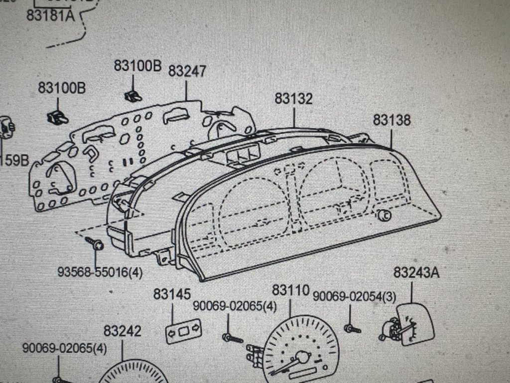

    I am looking for 8313804040, which is what I believe my truck needs. A Canadian parts place seems they may have them. I am awaiting a response from them and if they ship to the USA. Polishing is nice for blury glass, but mine has 2 cracks in it.

    Isn’t it a flat piece? If you’re scared of polishing, maybe you could trace it and cut a new one from acrylic

    it’s actually not. It appears flat to the eye for what we see. Thanks for your suggestion though!
