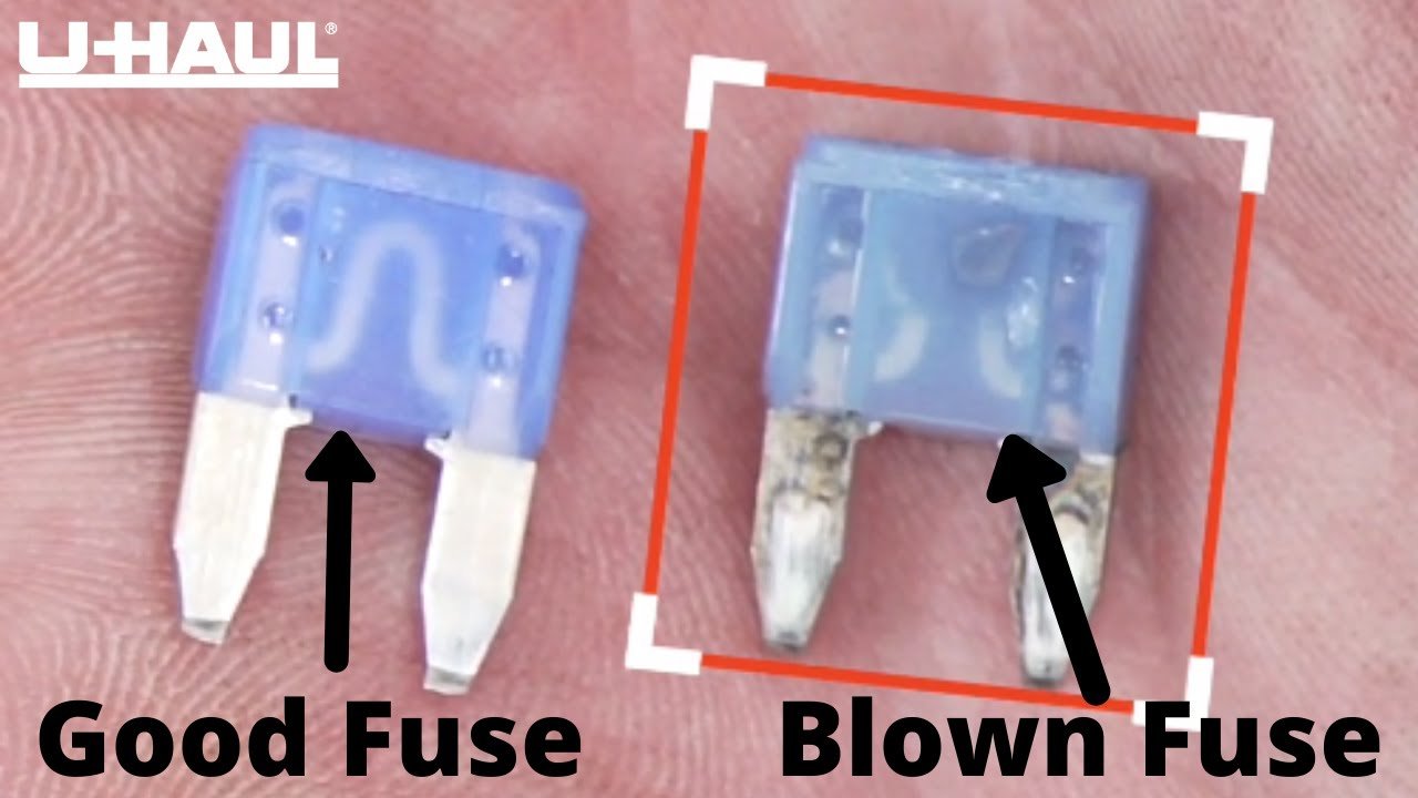

    What instrument do you have/use to verify a bad fuse? Besides the eyepercent...:D

    Did you LOOK at fuses?

    Unlikely you did permanent damage. The fuse box cover has a diagram. If you don't have a tester you can you pull the fuses (please, one at a time so you put them back correctly) and eyeball if they're blown. There's two fuse boxes: one in the engine bay and one under the instrument panel on the left side. The AC fuse is in the engine bay but the gauge is in the cabin.
    If the diagram is missing for some reason, it's here.

    I have inspected some of the fuses in both boxes, such as eg1 number 2, and some others. None of the ones I pulled so far are blown, I will have to check every single fuse and pull one by one like you said.
