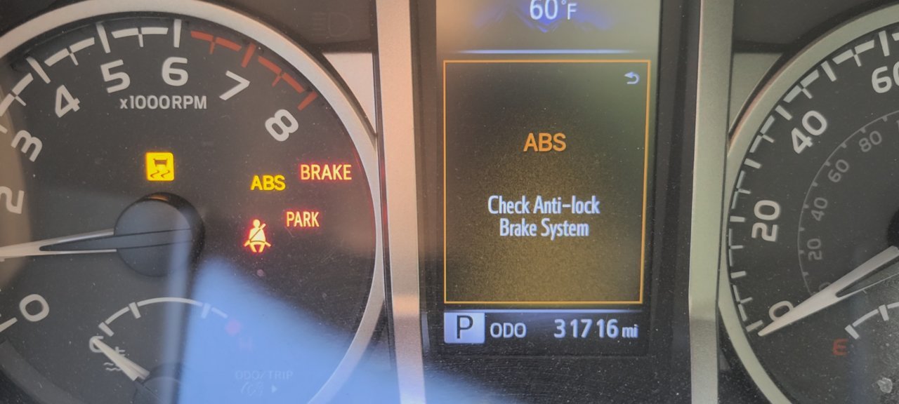

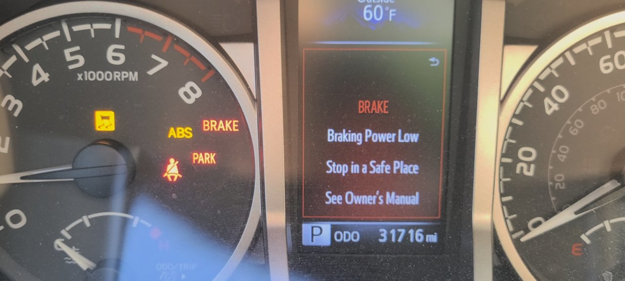

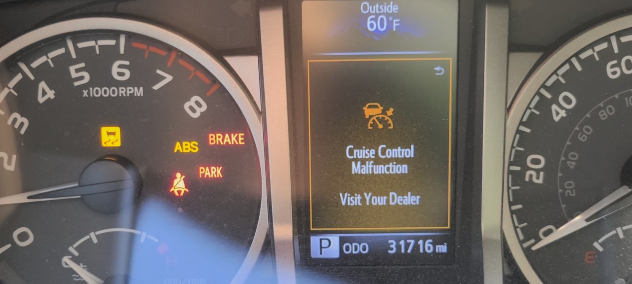

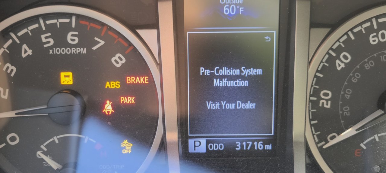

    Instrument cluster went nuts and threw all these error messages (abs error, brake system failure, cruise control malfunction, etc). Never had this happen before, and this 2020 Limited has 30k miles. I have since had this checked out and fixed (dealer charged me $80), but thought it would be interesting to put this up for everyone to see and possibly learn from. If there's any interest I'll post up what was the culprit. There is a video that shows it, but I have had no luck uploading the 80mb mp4. Ok, here's the youtube link (hopefully)... https://youtu.be/zX-NXAr49FI

    Ok, sorry guys, just got back to the house. It turns out that the mechanic plugged in their diagnostic computer to the OBD port and it indicated a problem at the drivers' side rear wheel. Upon inspection, he found the speed sensor cable cut (more accurately, chewed) in half. Apparently our local squirrels have gotten bored. The dealership just charged me a diagnostic fee and that was it. Now I'm going to buy pellets for my son's pellet rifle....
