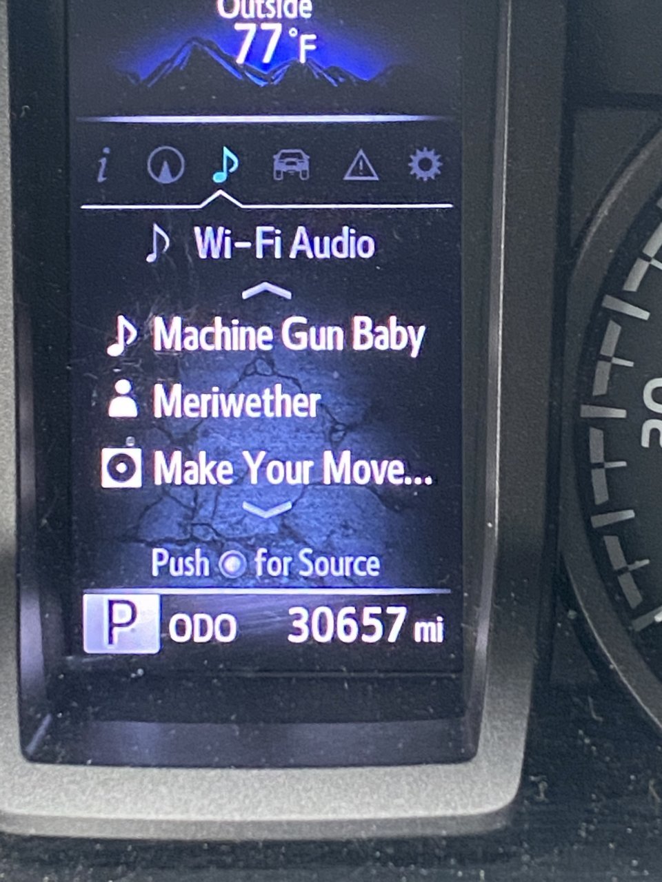

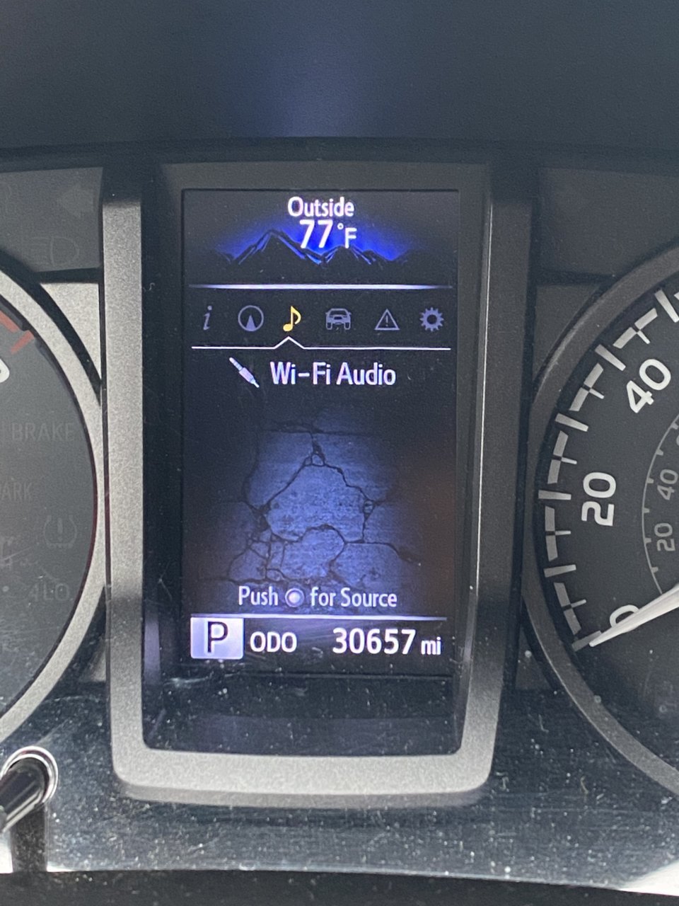

    I'm curious if anybody is having this problem with Maestro RR. The song titles will not display in the instrument panel when you start the truck and car play/bluetooth is connected. Only way for the song titles over bluetooth to display is to select FM Tuner, then back to Wi-Fi audio. Something wrong with my Maestro? 01A8DF62-175A-424B-BDF2-0E2463CD6DCA.jpg

    Maestro RR updated to v2.9, issue went away. Thanks for your help Destin! :cheers:
