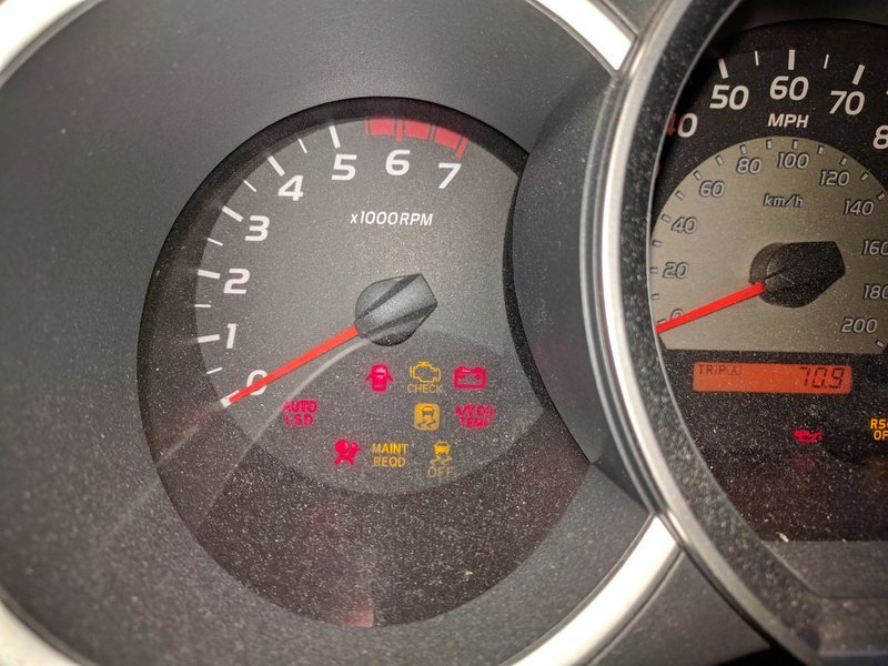

    The photo is just to show all the lights that com eon when i switch the truck on, but only the check engine light and the slip indicator light stays on (icon directly beneath the check engine light).
    Hoping I don't have to replace the ABS pump / computer (looks like a big undertaking).

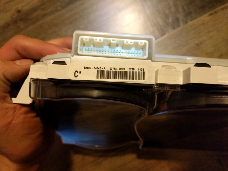

    I removed my cluster last night and got the part number. Went on ebay, ordered a rebuilt one for $140 + 40 core charge. That company is supposed to reprogram the mileage on the need cluster to match my existing. Will report back once I have that installed. 2017-06-22 21.16.01.jpg

    I replaced the cluster. The replacement one didn't work. The needles stopped moving. I drove the truck around, unplugged the battery to try to reset the ECU... still no go. I noticed that the speed on my scangauge 2 was still reading 0 mph, same as before the cluster swap. I put my old one back in and everything is back to where it was (with the check engine and slip indicator). I think the replacement cluster didn't work because either it was defective or it didn't match my year exactly. It appeared to have all the same lights though (ATRAC, 4x4 lock, etc.). The replacement cluster had a part number of 83600-04E41-A which according to what i read is interchangeable with for my existing cluster (part number 83600-04E40-A). Surprised it didn't work.

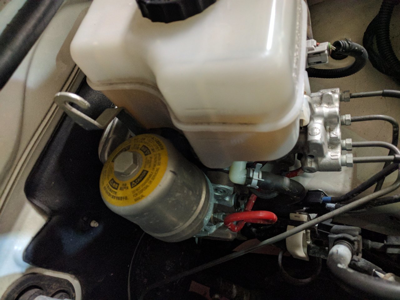

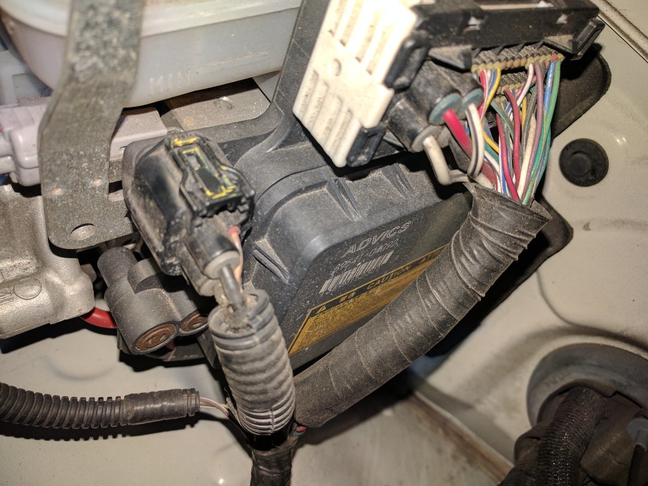

    I don't see the part number on the skid control ECU (am i looking at the right part?)

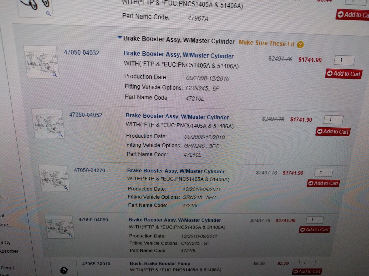

    I believe I will need either 47050-04032 or 47050-04052. I got my truck March 2010 new. It's a 1-1.5k part so hoping someone can point me in the right direction.
