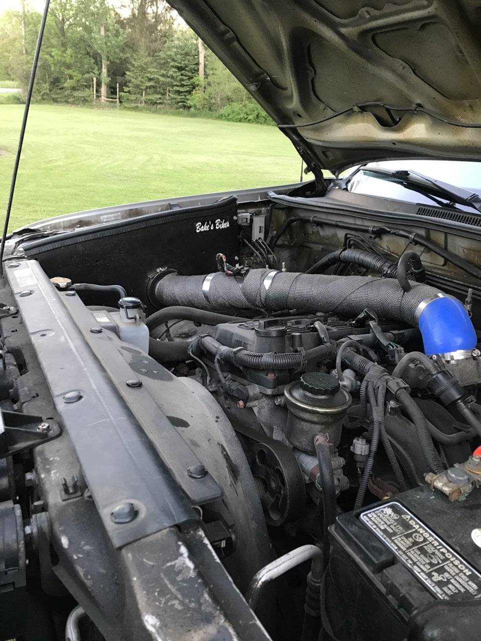

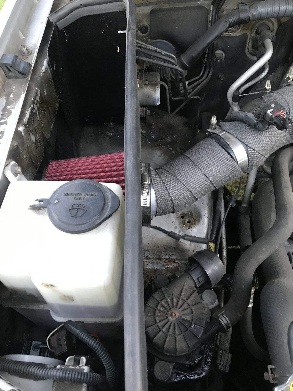

    Trying this homemade intake,
    Found a 3” inch maf off of a Nissan Altima that used the same style sensor, intake works very well, uses the factory air inlet, and very loud, my only complaint would be the engine light comes on at times,

    CEL coming on because of that loose hose clamp?

    Good question, I’m pretty sure they are all tight, it does look loose in the pic, but I think that’s my mediocre wrap job, I will check tommorow, I might have read that the length of my intake may cause a code aswell?? Thanks for the suggestion it’s appreciated

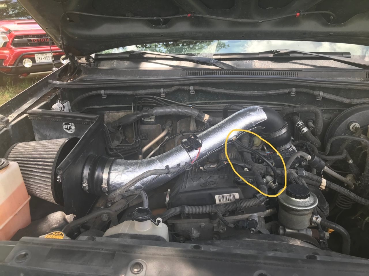

    There should be a vacuum line running from the fuel pressure regulator to the intake pipe. This may be why the cel is coming on. How is this routed? Its hard to tell from the pic, but i circled what im talking about

    Heres how i routed mine on an aftermarket intake
