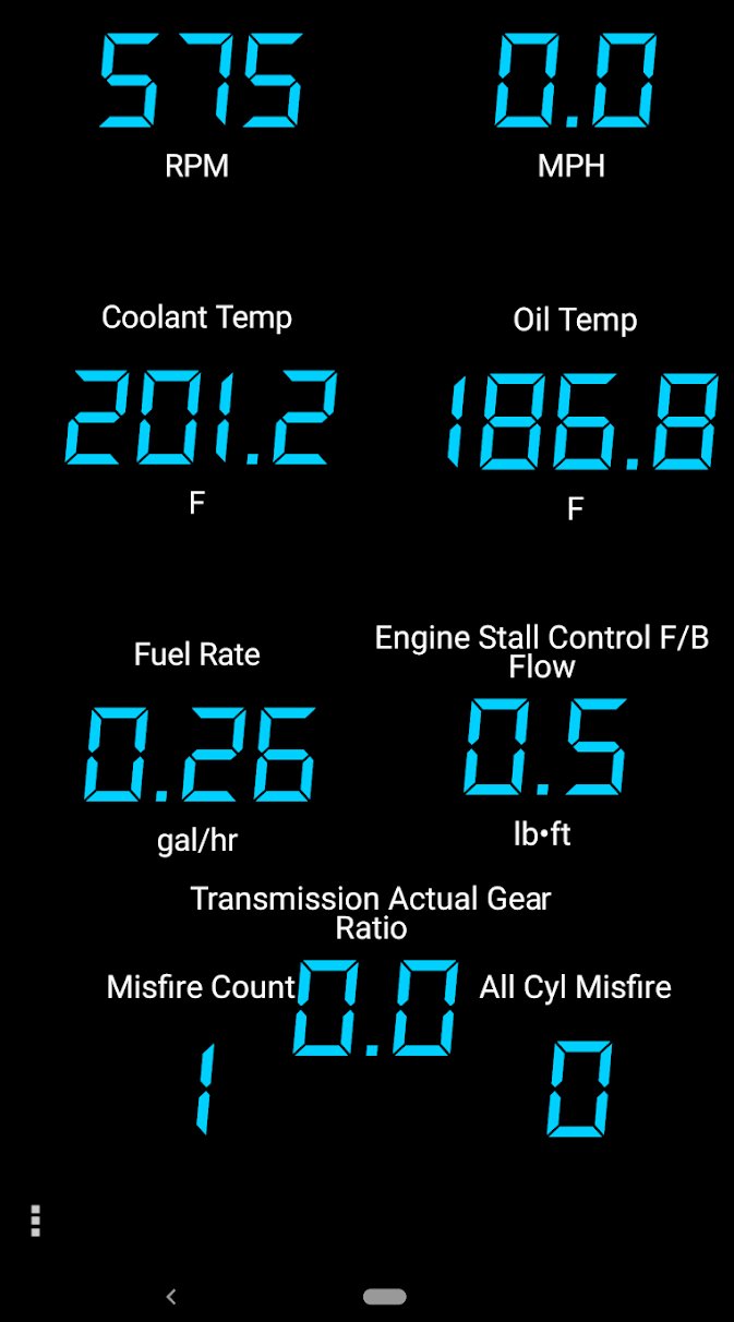

    I'm not 100% sure what it is, but it also happens when moving the truck around with just the clutch. There is an anti-stall feature that kicks in there and can be monitored on OBD. Look for Stall Control F/B. It typically kicks in when the revs drop below the target idle speed, as seen below.
    vF Tuner thinks this might be related to improving DFCO in 1st gear also, but there is no solution for it quite yet. My hope is that the Stall Control will go away with the DFCO fix.
    I have seen the Stall Control value change while driving. It may be the same thing that you are asking about.

    That's weird you've heard it with just clutch work; mine only does it when you touch the throttle.
    What are you using for a monitor?

    I have that PID in both Torque Pro and OBD Fusion. In Fusion, search for Stall.
