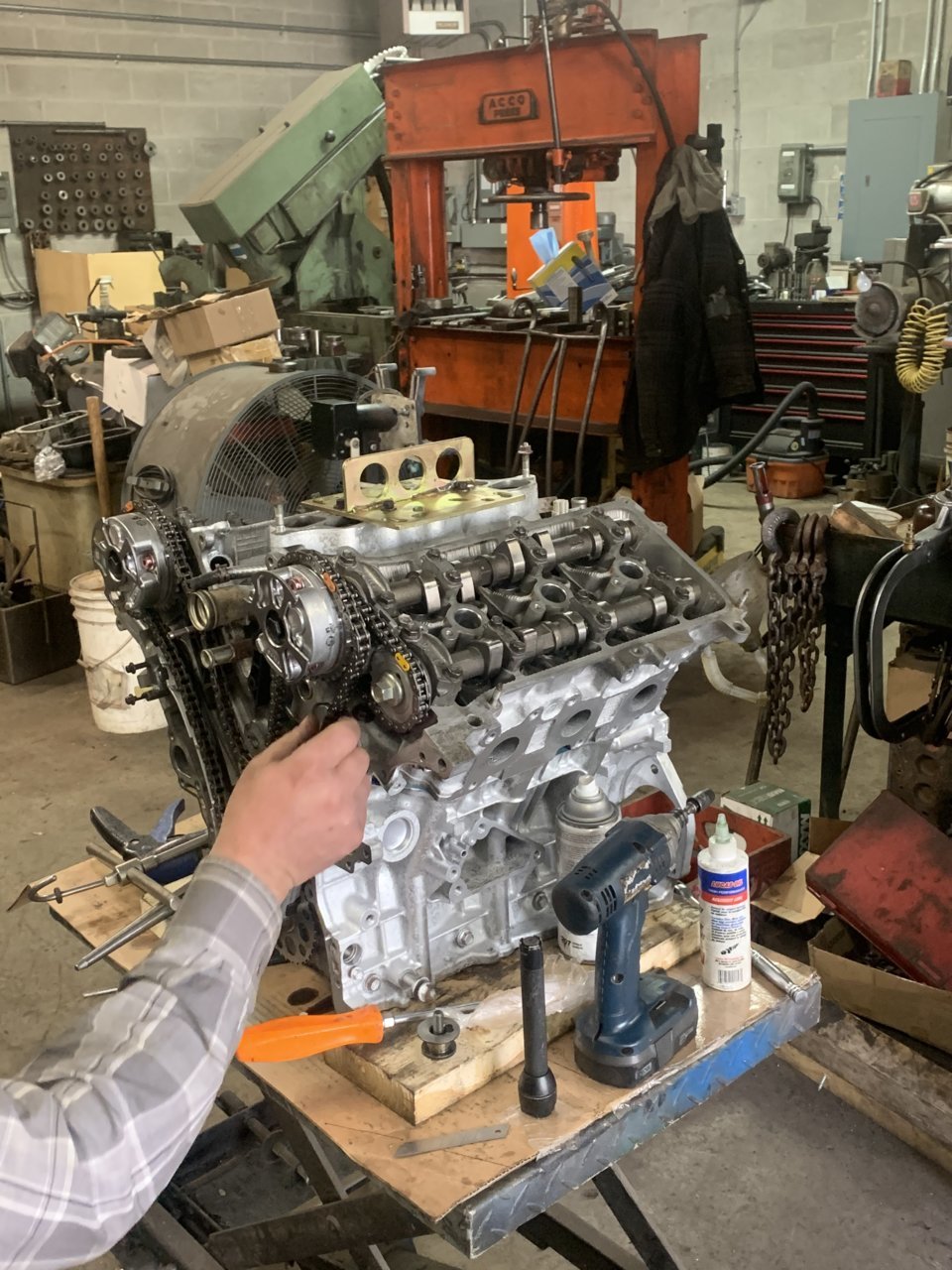

    Hey there I recently had my engine rebuilt through Toyota and supplied them with LCE .030 over pistons, pro dual Valve Spring & Retainer Kit, URD Cam Gears & a few other parts for the build.

    yes I supplied them the parts and the engine out of the truck. they subbed it out to their engine guy for the machine work and assembly then they installed it. I even got 12 month unlimited km warranty.

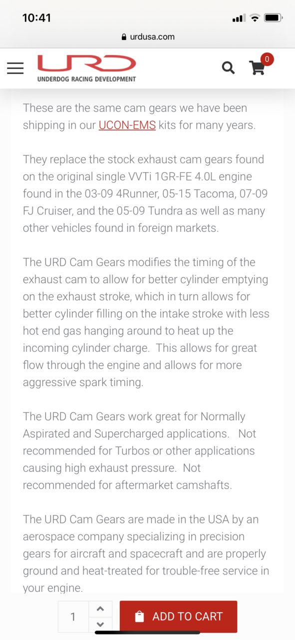

    Are you running the Cam Gears though? They slightly adjust the timing.

    Any cam gear will create an issue if it’s off a tooth lol. The URD ones are suppose to modify the timing slightly.

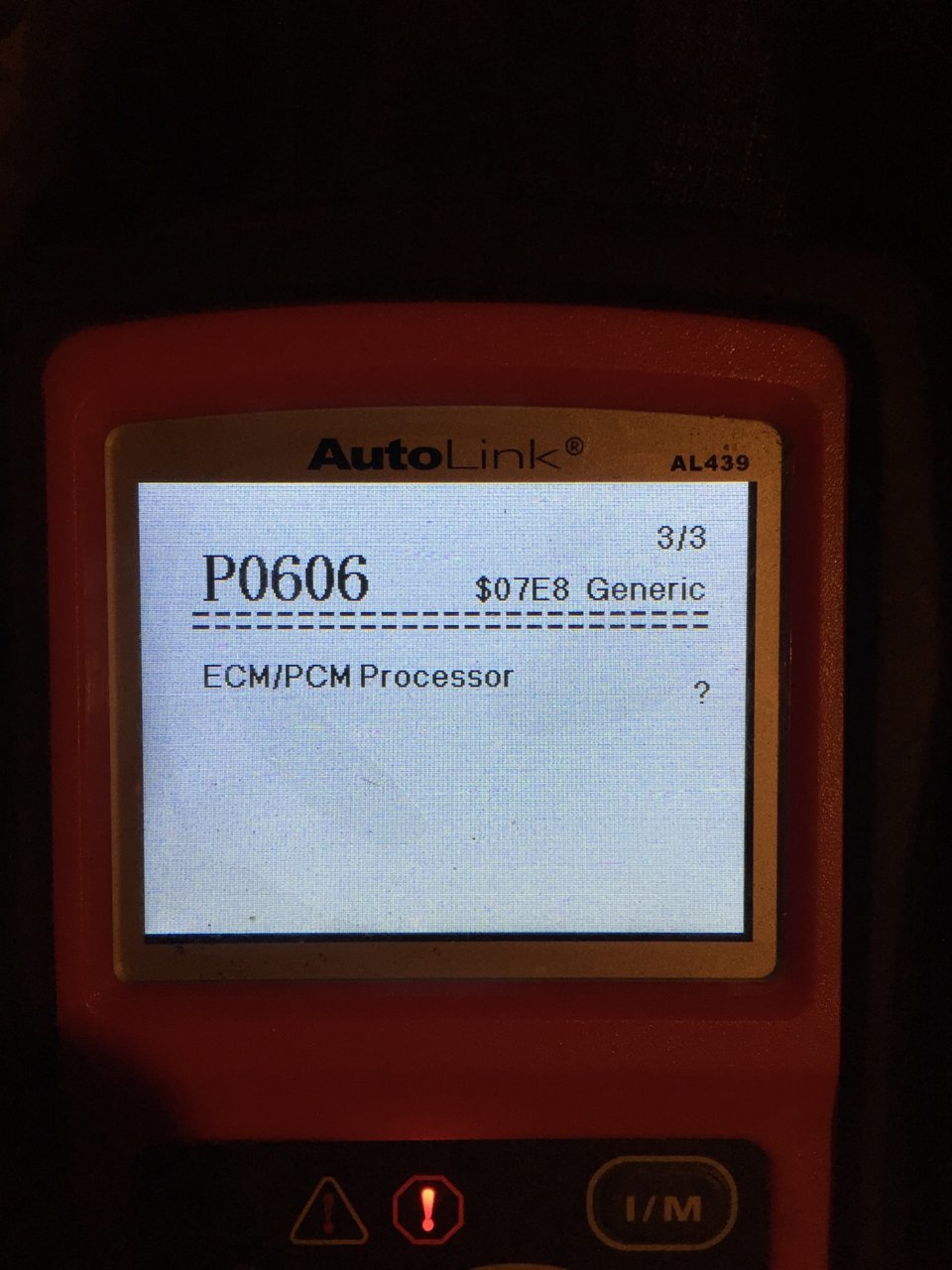

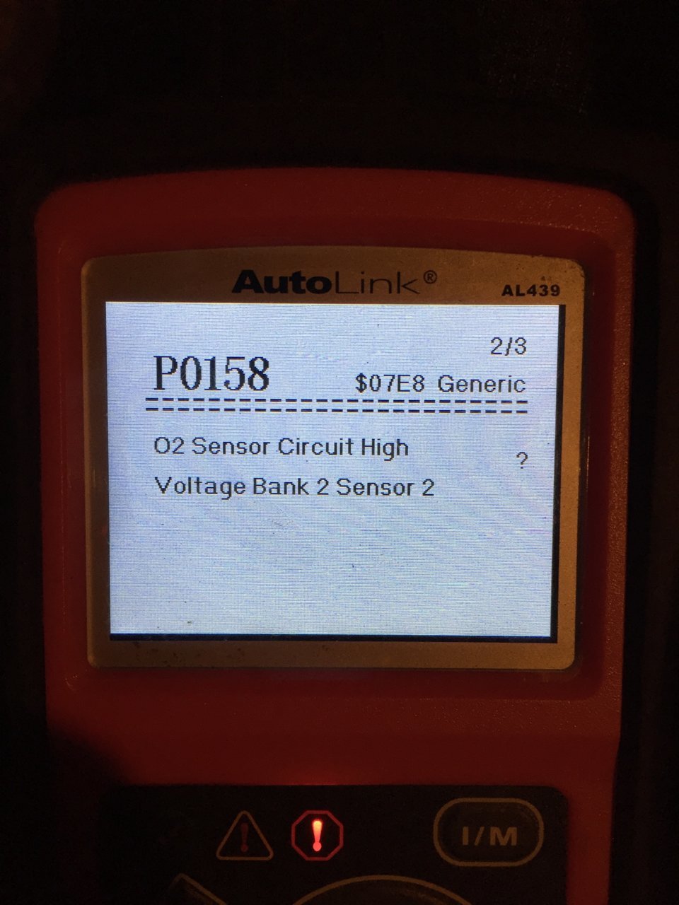

  14. Aug 27, 2021 at 5:29 AM
    Dirty-Taco
    Dirty-Taco [OP] Member
    Apr 20, 2021
    #363326
    7
    Nate
    Burgessville Ontario
    White 2007 Tacoma
    Fabtech 6” drop bracket lift 2.5 6” lift coilovers 2.25 10” stroke Rear shocks LCE .030 Street Pistons LCE Pro dual Valve spring and retainer kit URD Cam Gears 35/12.5/17 Kuhmo Road Venture M/T 4:56 Gears Android Double din head unit with Nav Need a front bumper lol
    Hey all sorry for the delay I’ve had a lot of shit going on.
    truck seems to be running fine now and the code before is gone. The new codes coming up are
