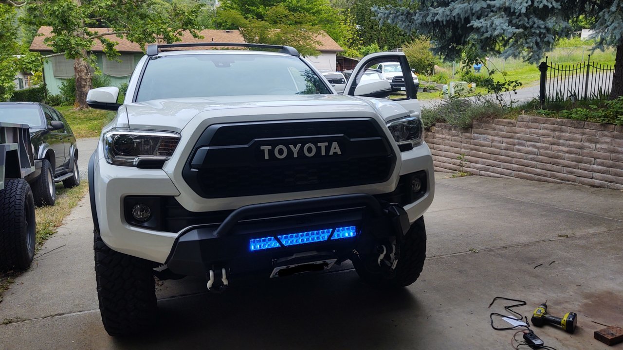

    I love my hiline. I got the Smittybilt winch for in. Ran a in cab line too

    looks like you are running a lower bumper hidden light bar. Assume it's a 32" bar but is it a single row or dual row bar? Hoping my dual row Caliraised bar will still have clearance with this bumper and a Smittybuilt X20 Comp winch. Any feedback is appreciated.

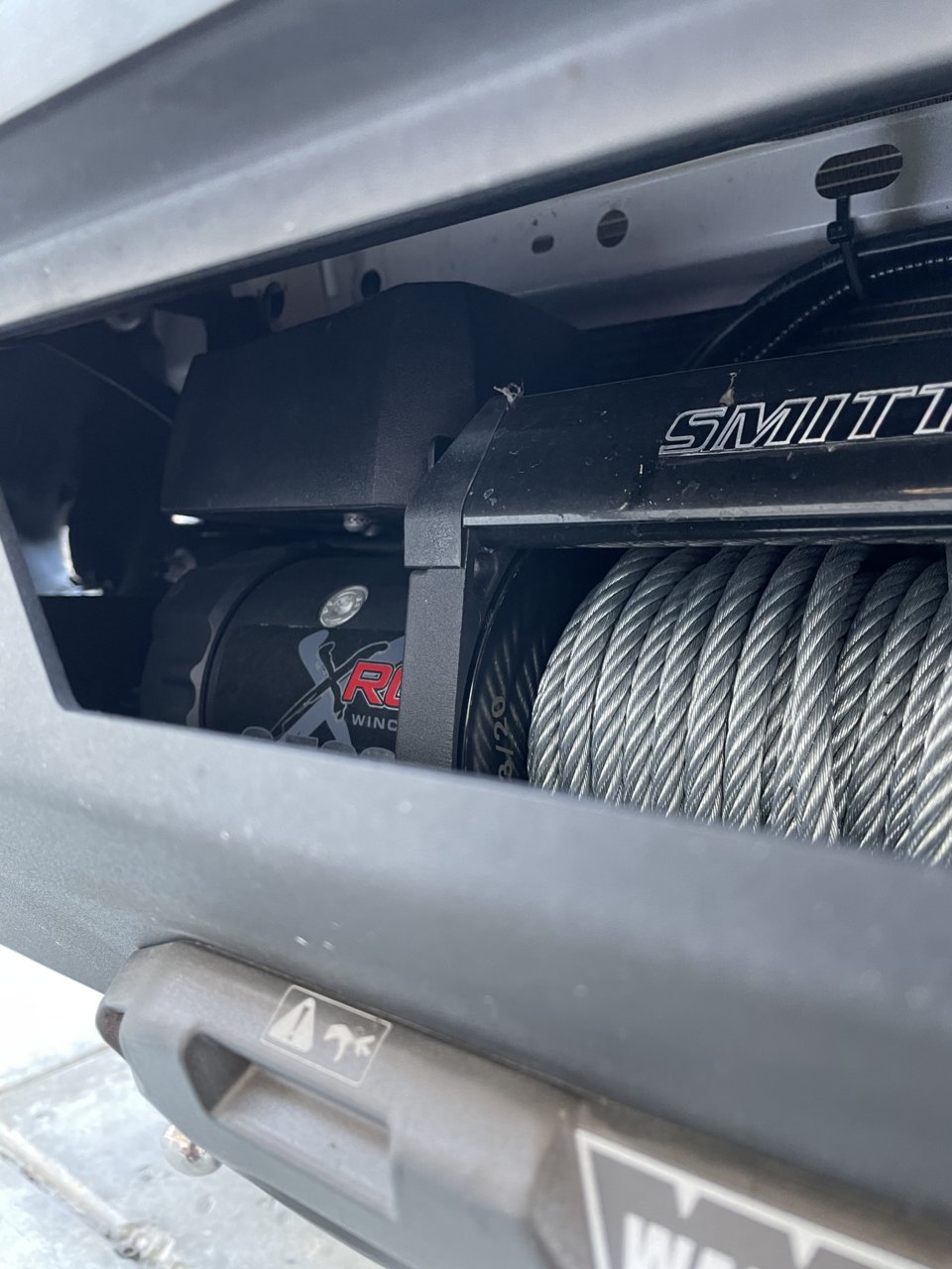

    Easy install, clean look. Smittybuilt X20 synthetic line winch installed.IMG_20200610_164209767_HDR~2.jpg

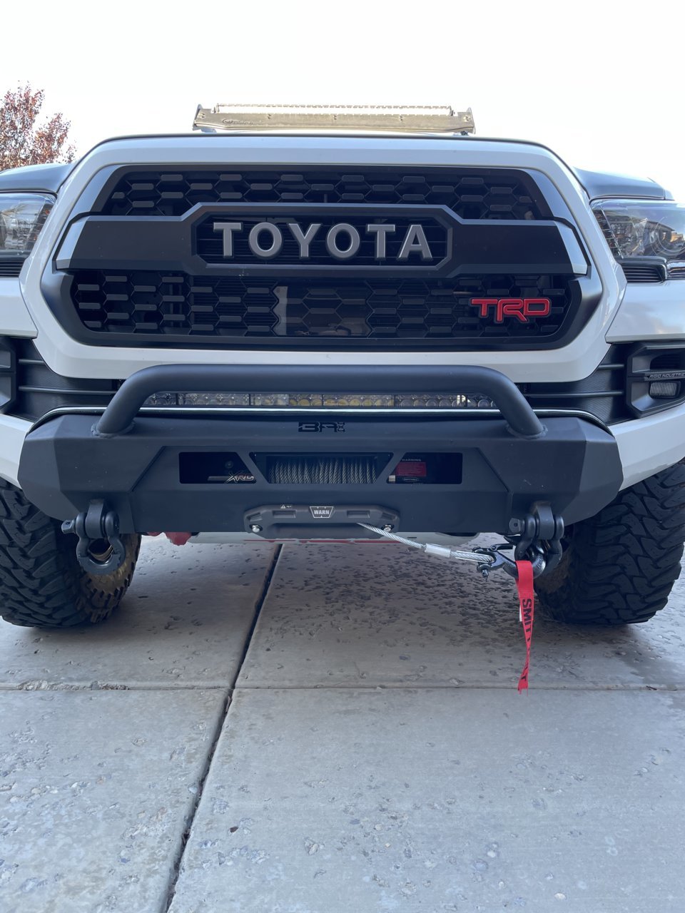

    I got one too. Also did a Smittybilt X20 winch and a 22" LED light bar. All fit fine for me. Just move the control box to the passenger side and you'll be good.

    Yep, the winch manual should show you some different mounting options. I just basically flipped it to the passenger side. The light bar sits further in the bumper so there's more room than you think. It's also tons easier if you mount everything to the bumper before you put it on the truck.
    A quick photo chop and this is basically what mine looks like from the inside/backside.

    I hope this helps. It’s kind of hard to get a good photo of how much space is left.

    Awesome - thank you both for those photos. That explains it all.

    looks like my dual row hidden light bar will fit based on your picture. Not using the light bar cutout in the bumper looks like it provides good access to the winch as a bonus.Thanks for your help, much appreciated!

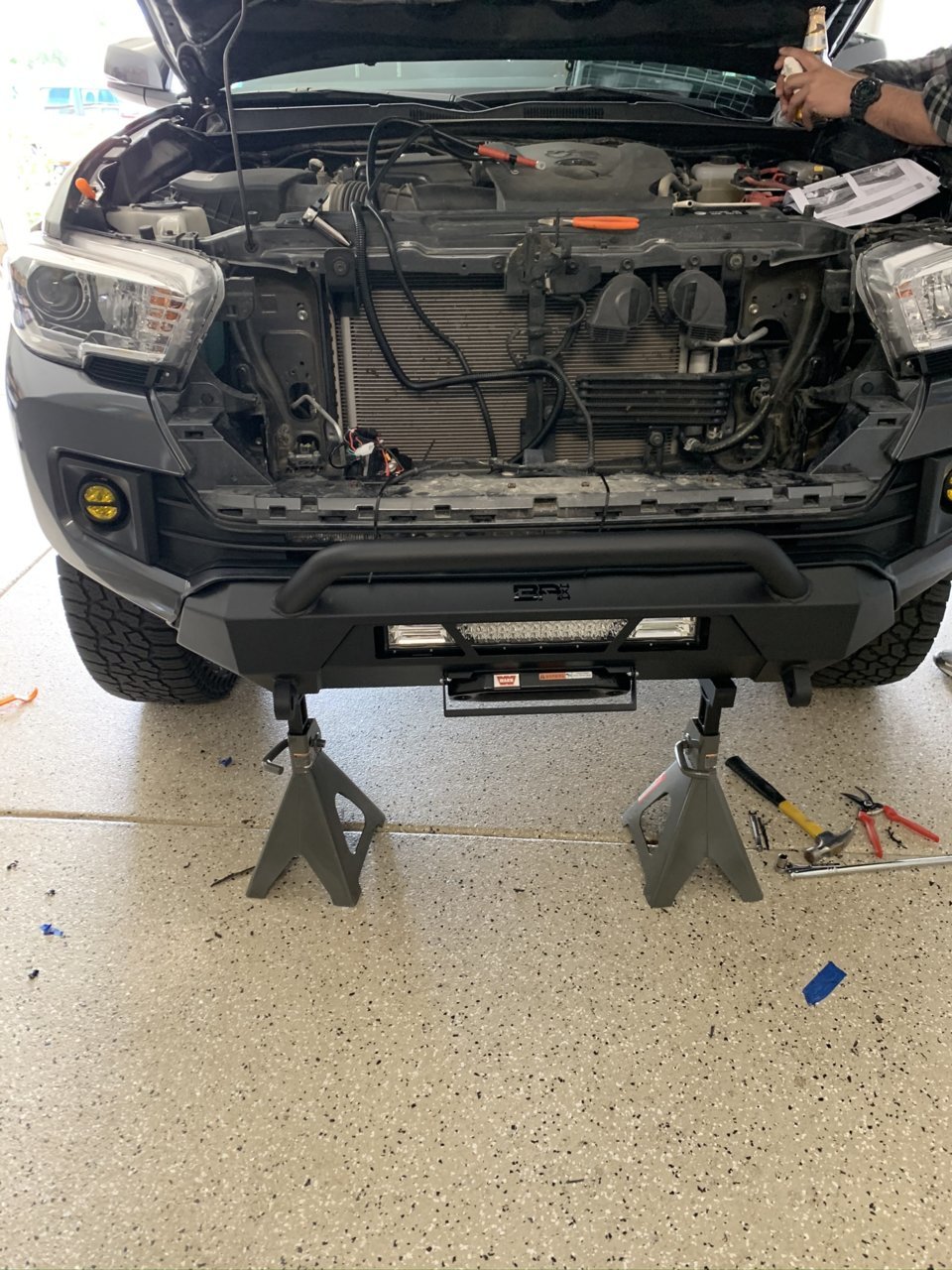

    Large winch, dual row light bar. All fits perfectly.
    My winch is a Warn Zeon 10-S, I did not move the control pack since I can access everything from the top when the hood is open.
