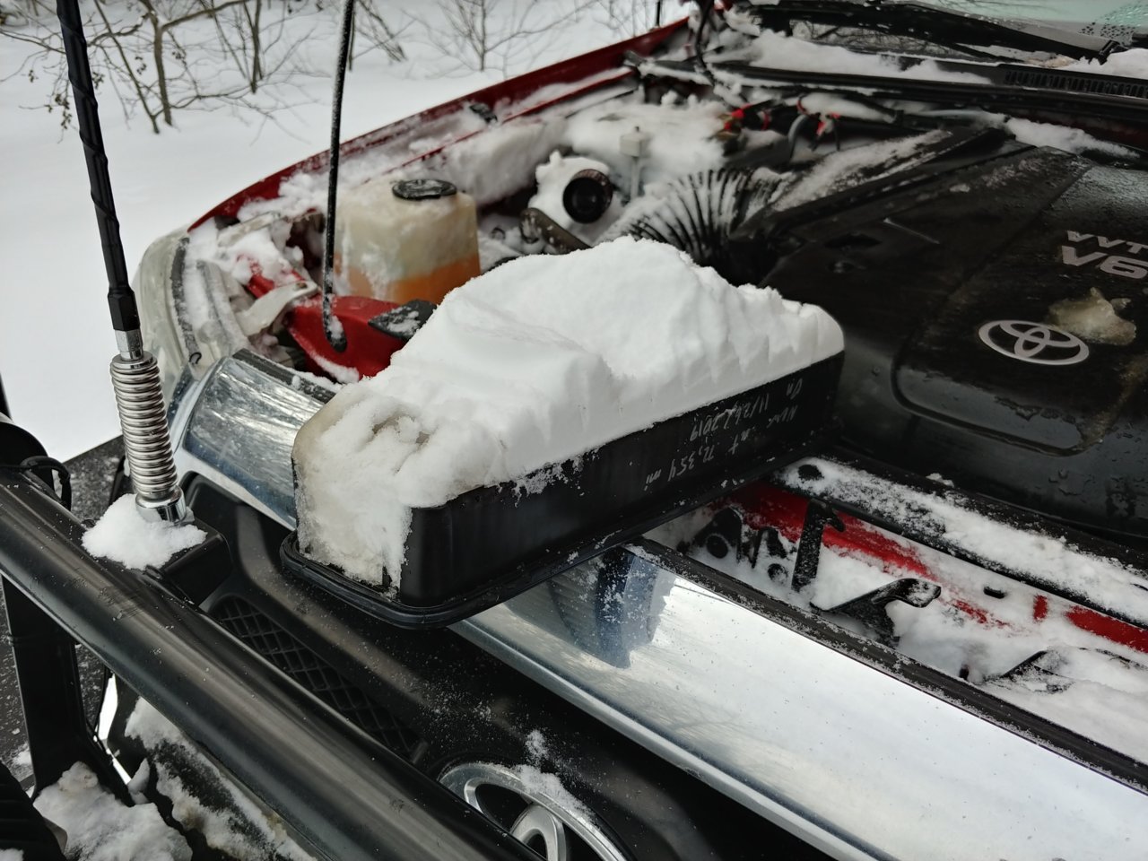

    Can confirm that it does not seem to hurt the engine, just makes it absolutely gutless. Though I would be skeptical of getting every last bit sealed off enough to stall it.. Especially at idle
