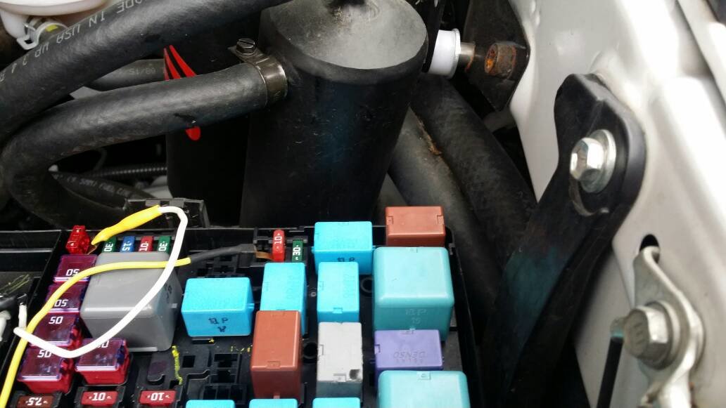

    I bet it's just jumped to the wrong fuse. in the morning I'll take a pic of my fuse panel to show you the exact one it should be on. If that does not turn out to be the problem maybe relay?

    It's the yellow wire it says ecu on it.

    From the looks of that photo, it appears to be connected properly. The fuse slot should read: 10-Amp Fuse EFI No. 2, that 10-amp fuse should be a long-pronged type that replaces the original shorty. (It comes with the supercharger kit). The yellow wire connected should have the "T-Tab" contactor that slides over the new fuse, as this is part of the Intercooler Pump Harness. You might want to check the ground wire that also comes from the same harness....make sure it is getting proper ground.
    In the installation instructions for the supercharger, there is a caution note which reads:
    CAUTION: When
    installing the fuse, make sure the tap is
    toward the rear of the vehicle (Fig 19-11).
    Hope this helps in some way.

    Thanks for all the replies. I took it back to the dealership I bought from, the pump was wired into the accessory lights on the front. When dealership got it they rewired lights to battery rather than ignition not realizing pump was then wired up to battery. All better now.
