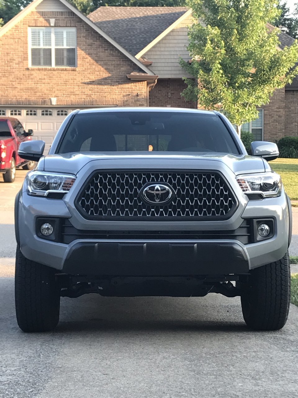

  8. May 27, 2019 at 5:09 PM
    Romad99
    Romad99 Well-Known Member
    May 13, 2019
    #293181
    86
    Clarksville, TN
    2019 Cement DCSB TRD OR
    I’ve never been one for plastidip, but I’m actually very pleased with how mine turned out. I HATE painting of any sort, but this was easy enough I didn’t screw it up. Plus it cost me like $5.99 for a can at Lowe’s.
    Rockefelluh likes this.

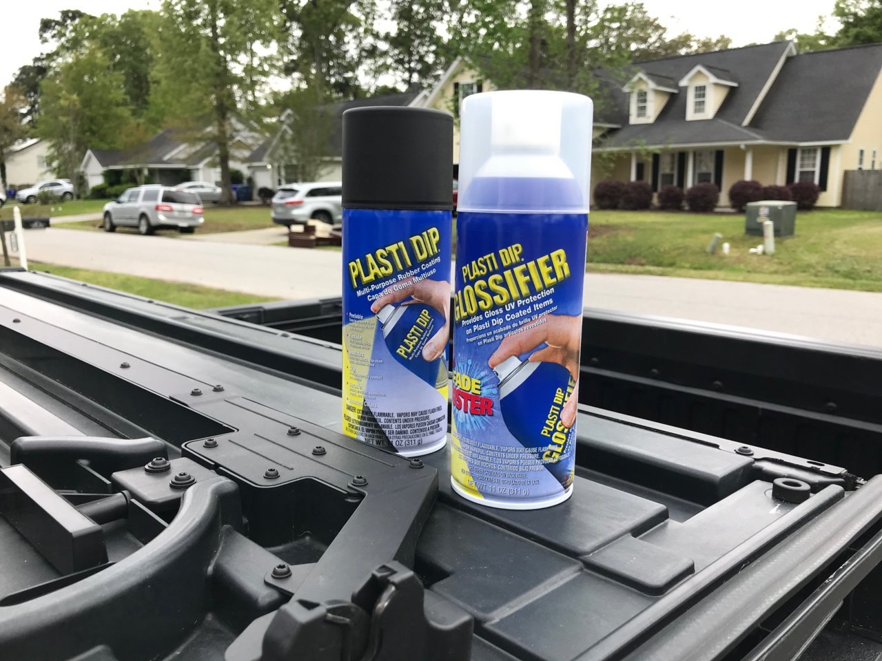

    jayandersen5
    jayandersen5 Well-Known Member
    Sep 1, 2017
    #228748
    398
    Jay
    South Carolina
    2017 TRD Pro
    OTT Tuned Yukon 5.29s 35x12.50r17 Yokohama MTs RRW RR7-H Wheels Dobinsons MRRs RRW hybrid front bumper ATH rear swing out high clearance bumper Alucab Explorer Canopy iKamper skycamp 2.0 Diode Dynamics SS3 (x4) and SSC2 SOS Sliders C4 full skids Smittybilt X20 Gen3 10k winch Prinsu Cabrack Expedition Essentials 3TPAM Caliraised 40" light bar ExtremeLED 30" light bar Total Chaos spindle/cam tab gussets and bed stiffeners Switch Pro SP9100 Power Tray
    I dipped my chrome grille bezel to match the 18/19 TRD grille and it has held up great. More coats is always a good thing - the thicker the coat the harder it will be for it to chip or scratch. Plus if it does you can always touch it up. Pretty sure I put around 6 coats of black and 2 coats of glossifier on my grille bezel.
    COS_TACO[QUOTED] likes this.

  17. May 28, 2019 at 8:21 AM
    #17
    jayandersen5
    Sep 1, 2017
    #228748
    398
    Jay
    South Carolina
    2017 TRD Pro
    I'll also add that mine holds up perfectly fine even with washing the truck with a pressure washer.
    COS_TACO likes this.

  19. May 28, 2019 at 8:38 AM
    #19
    jayandersen5
    Sep 1, 2017
    #228748
    398
    Jay
    South Carolina
    2017 TRD Pro
    I put two coats of glossifier on mine.

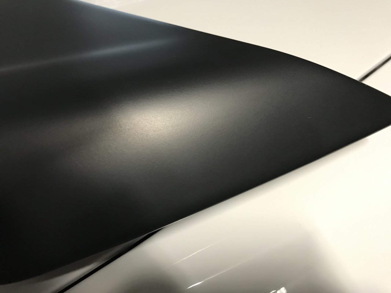

  20. May 28, 2019 at 8:59 AM
    #20
    jayandersen5
    Sep 1, 2017
    #228748
    398
    Jay
    South Carolina
    2017 TRD Pro
    With only two coats of the glossifier mine is more of a satin if anything - definitely closer to matte than glossy.
