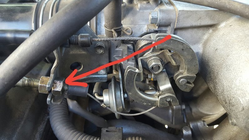

    I believe those still have a throttle cable. Make sure it hasn't gained slack/stretched over time.
    similar to...
    Check for vacuum leaks, all hoses are connected.
    Clean throttle body and MAF sensor.
