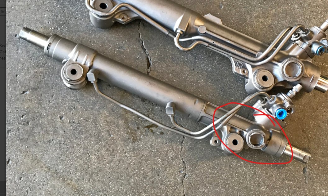

    Bottom is a 2nd gen stock rack. Loosen the lockring and the cap with the 4 notches in it you can loosen to pull the slider bushing out, clean it, then put it back in and tighten. Look up write ups on this for the 1st gen taco / 3rd gen 4 runner, slightly different location but same concept.
    You can get to the slider bushing if you remove the stock skid and turn the wheel all the way left. Take a pair of channel locks and you can loosen / tighten the lock ring, and for the cap, I used a flat piece of metal to key into the 4 notches.
    garciav, coopcooper[QUOTED] and EricT like this.

    Yeah mine was pretty apparent, you could feel a good knock either when going over little bumps straight (as the tires were moved by the little bumps left n right) or when transitioning from left to right pressure at the wheel there was a dead space then a knock when the slack was taken up.
    The adjustment is VERY touchy, too much till too little preload in 1/8th of a turn type of touchy. But its easily adjustable just takes a bit of time.

    How do you know when it's adjusted properly? Just when there's no play and it's not binding?
  18. Jun 24, 2021 at 1:27 PM
    #38
    nd4spdbh
    nd4spdbh Well-Known Member
    Oct 7, 2013
    #114055
    14,550
    SoCal
    13 DCSB TRD OR v6 Auto
    No play and it's not so tight that the wheel doesn't want to return to center

    Totally had this problem on my first steering rack. Slowing to a stop sign, any bumps in the road would shift the steering wheel. And it shook going down hills sometimes even though I wasn't on the brakes. Never knew why but after reading this - totally that bushing being too loose. And I suspect the sustained action of it being too loose probably wrecked the seals.
    I'm on my second rack, about 38k miles on it, and it feels loose. Starting to do the same stuff again. I don't see any leaking yet but it's definitely time to adjust it up! Getting an alignment next week, I'll see if they can't do it when they are in there. If not I will. Great info as always guys, thank you!
