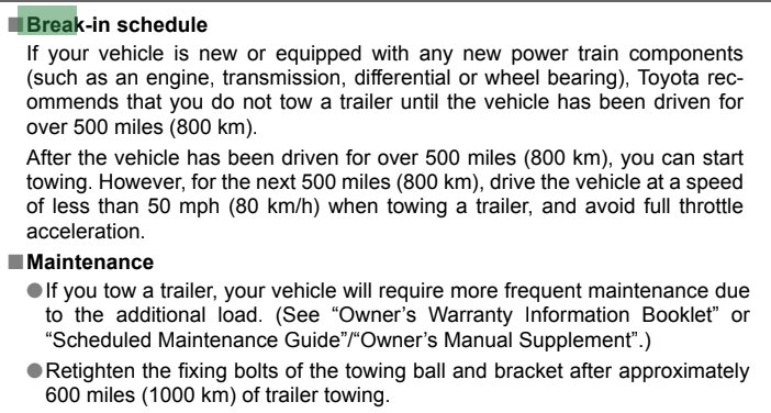

    It doesn't.
    It just says that we should avoid towing for the first 1k, or something like that. There isn't even a driveline fluid replacement noted in the standard service categories. Only the severe service.

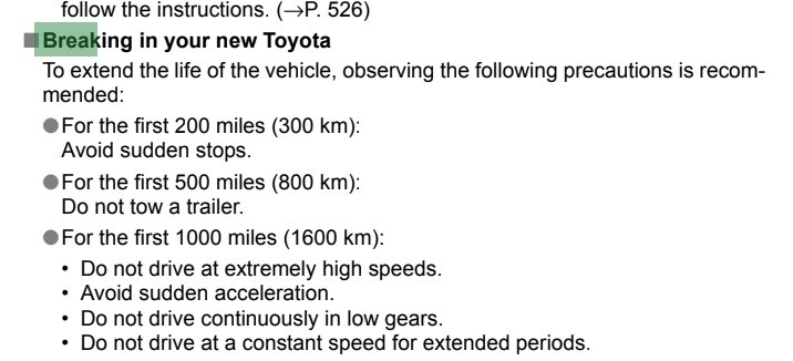

    Exactly. Engine break in is usually 500-1000 miles as well, yet first oil change is at 10,000 miles per service manual.

    "Do not tow a trailer" is Toyota's operating restriction for rear diff break-in. Again, your choice if you want to drain out all the metal shavings from break-in afterwards. Keep in mind the rear diff has no filter, just a weak drain plug magnet.

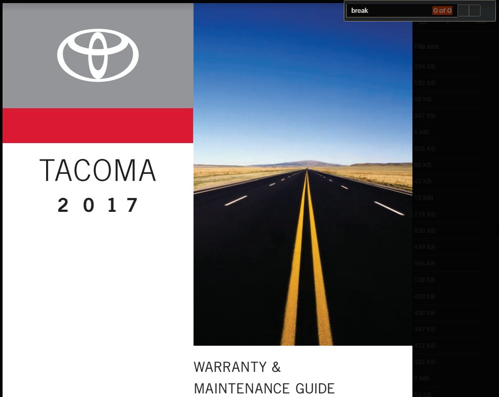

    According to my 2019 Warranty and Maintenance Guide, 15,000 miles is first “inspection” of differential oil, and “replacing” for special operations such as towing or heavy loading.
