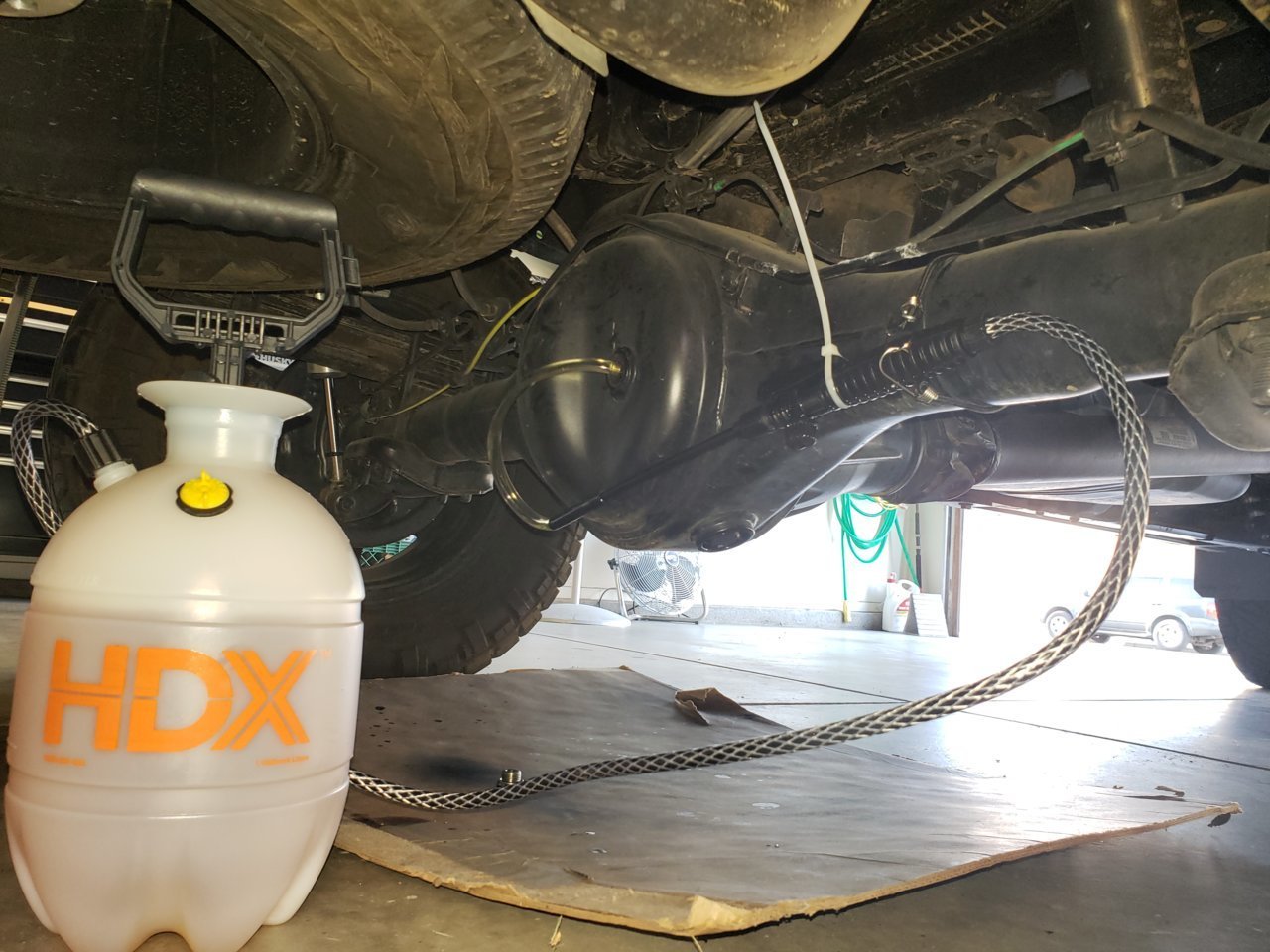

    I'm not 100% sure what you are talking about since I never had an outboard (or inboard), but this is what I used on the first go:
    https://www.amazon.com/gp/product/B000BQW5LK
    It took a while, esp the rear diff, but worked. For $20, the sprayer would make speed and storage good for me.

    So here's a cheap setup for the manual transmission. You need a few feet of 3/8"I.D. clear vinyl tubing and an old conical shaped gear oil container. Cut the old container in half (your making a funnel basically) and shove the tubing on the old tip of the container and shove a clothes pin through the hose and tip to keep them together. I place the created funnel next to the brake reservoir and route the hose along the firewall down to the fill hole in the transmission. It won't fill super fast but standing and dumping fluid into a funnel is pretty easy.

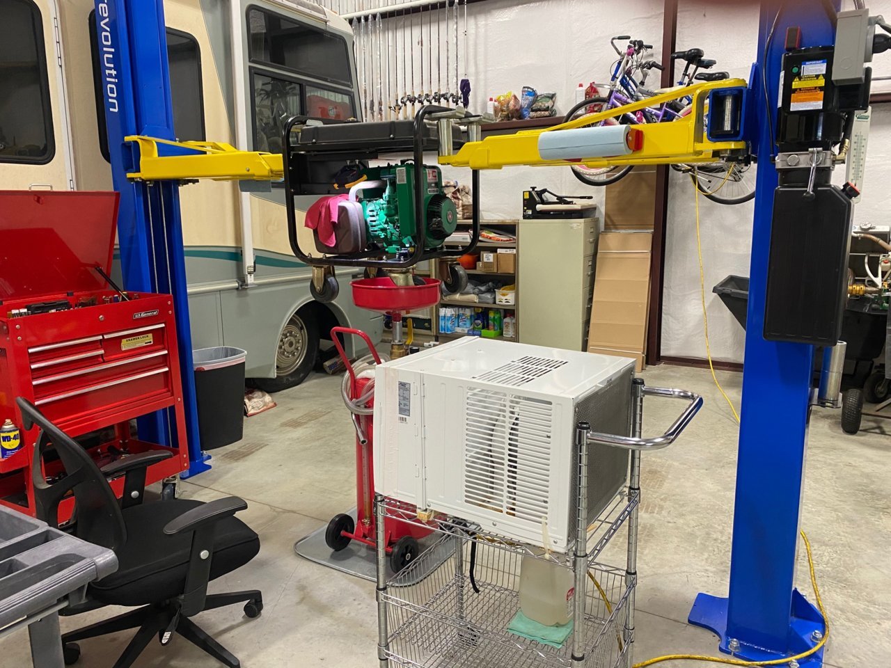

    I splurged and bought this. Makes the diffs and transfer changes so quick and easy. And the tire rotations. And changing those blades under the ZTR deck. Doing a generator rebuild right now and it makes it so much easier. The mountain now comes to Mohammed! That $9 Walmart pump will be the cat's meow. I've done quite a few messy gear oil changes in my lifetime, and that pump-up sprayer is truly a lightbulb moment!
