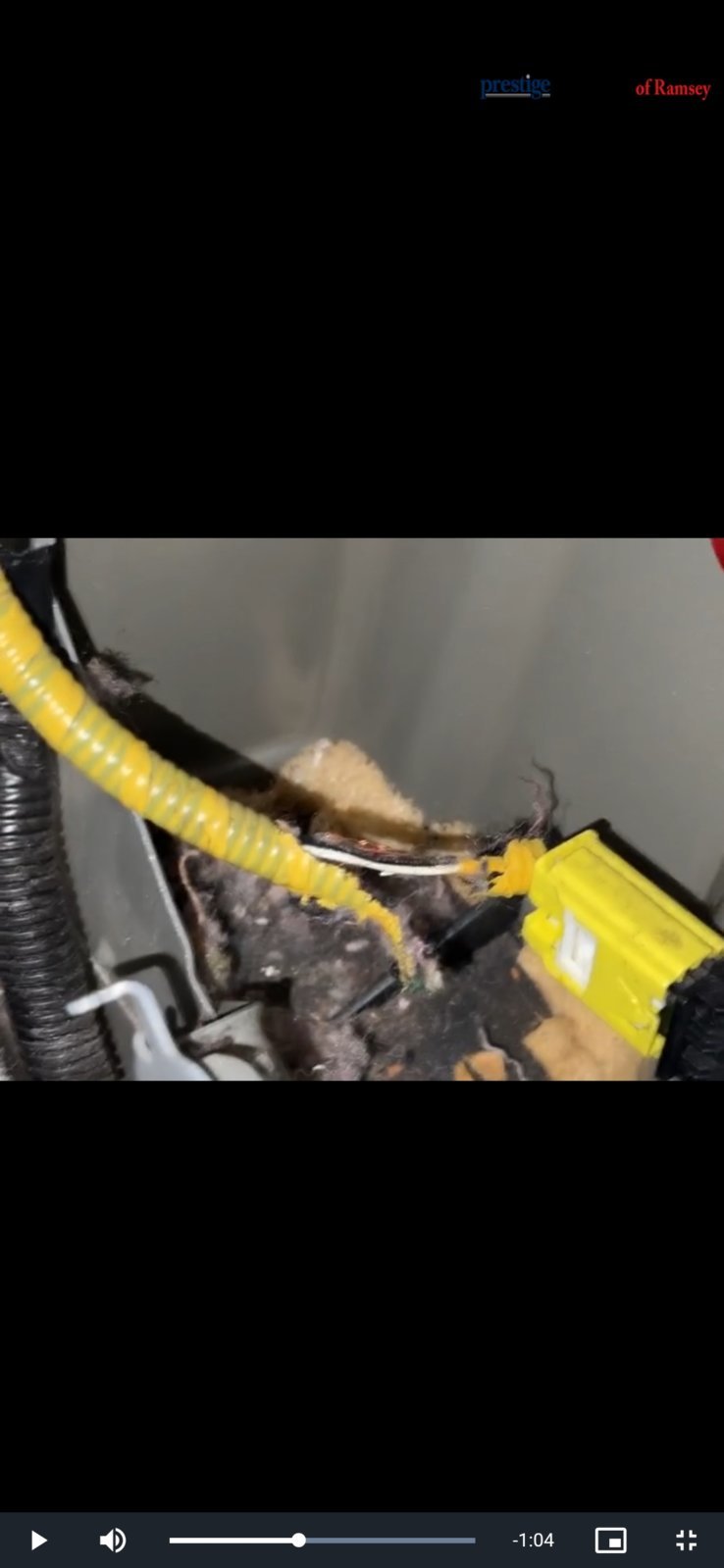

    Lakeland in Florida said they don't have it -misprint on sight.. Thanks guys for input. I can fix most things but wiring and electronics not my cup of tea. I'm stopping at the place this week to see if they have a remedy for it. I wish I knew it was this issue b4 I brought it there. My buddy's and I could do it it. I'm trying to post a pic of it. Thanks again Randy & DM!

    The pick and pulls I tried near me don't have one either , it's Vin specific. I could broaden my search area but at this point just want to solder it back together...

  9. Apr 20, 2024 at 7:16 AM

    Looks like there might be enough wire left on that connector to make a repair without replacing it but it's hard to tell.
    I wouldn't be afraid at all to repair that, it's in the interior behind a panel so very low chance of it getting moisure in it or it being disturbed.

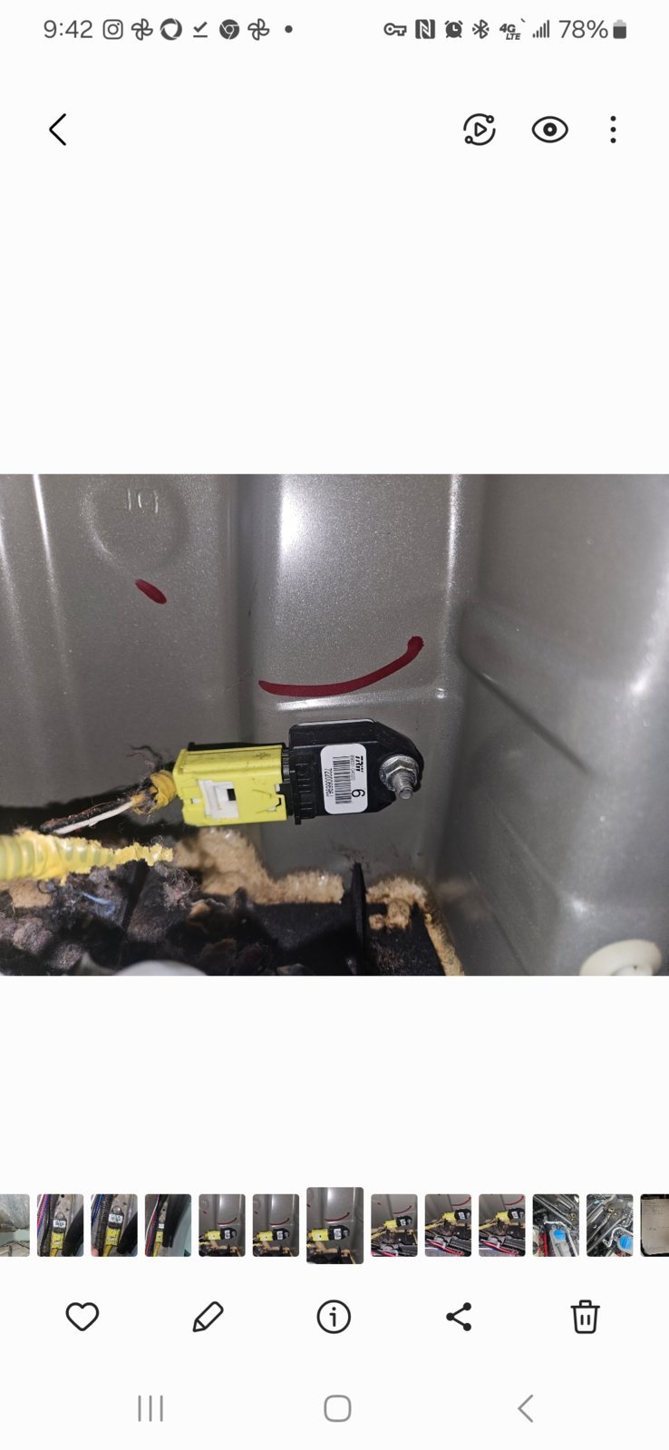

  11. Apr 20, 2024 at 8:29 AM

    Probably not much better. I agree DM. TY
