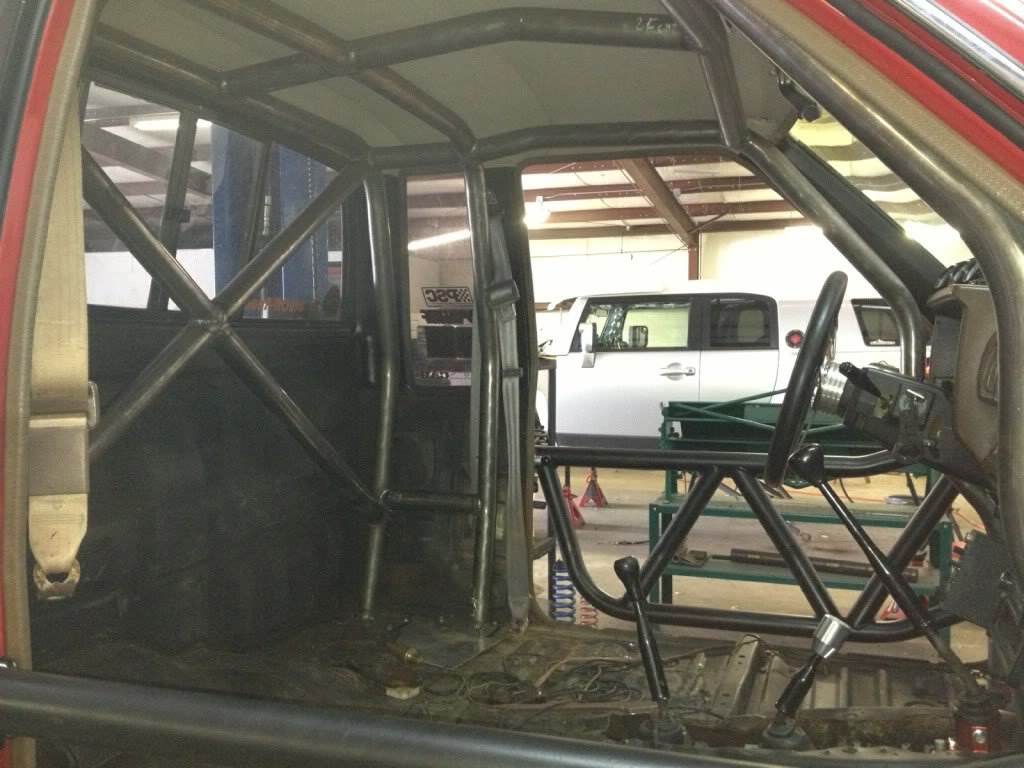

    I have the All-Pro removable cage in my 89 pickup. Fit is nice and pretty tight, installation was simple, and we added a few extra braces to make it stronger. My boss has the cage from 4xinnovations in his 84. We cut in some ID tube clamps from trail gear. Works awesome and removeable if need be. They are both pretty much the same and offer good head room in a small cab.
    Here is my 89 before i added padding to it.
