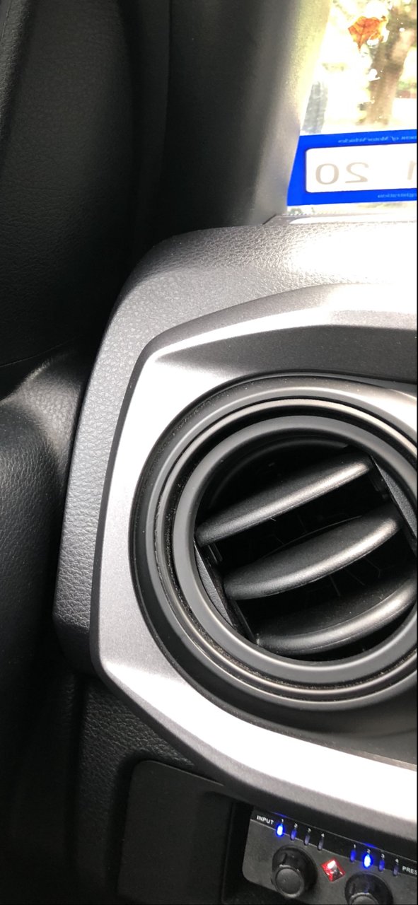

    The vent rings have plastic welds you have to break off unless you paint them installed. People have painted all sorts of stuff in their trucks

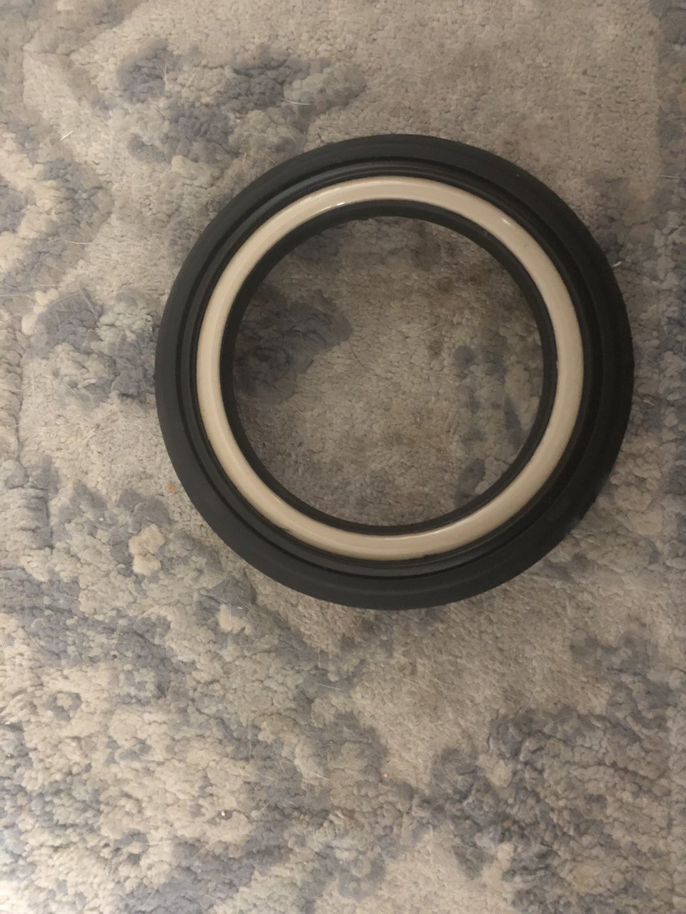

    Scuff chrome with 220 sandpaper. Clean and paint. Vent chrome rings will come off. AJT has a YouTube video on removing these rings. Take your time.B098A741-2223-4941-AE52-565CC371FA4A.jpg

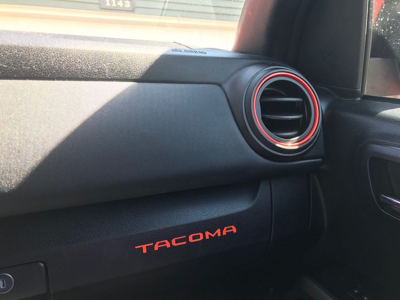

    Very carefully, I ordered too sets for screw ups

    After I painted mine, the fit was real tight. No need for adhesive

    Looks like a clean finish. :thumbsup:

    I lightly sanded chrome. I used three coats of paint. No primer needed. Take your time between coats of paint. No need to rush coats of paint.
    I waited a full day prior to reinstalling.

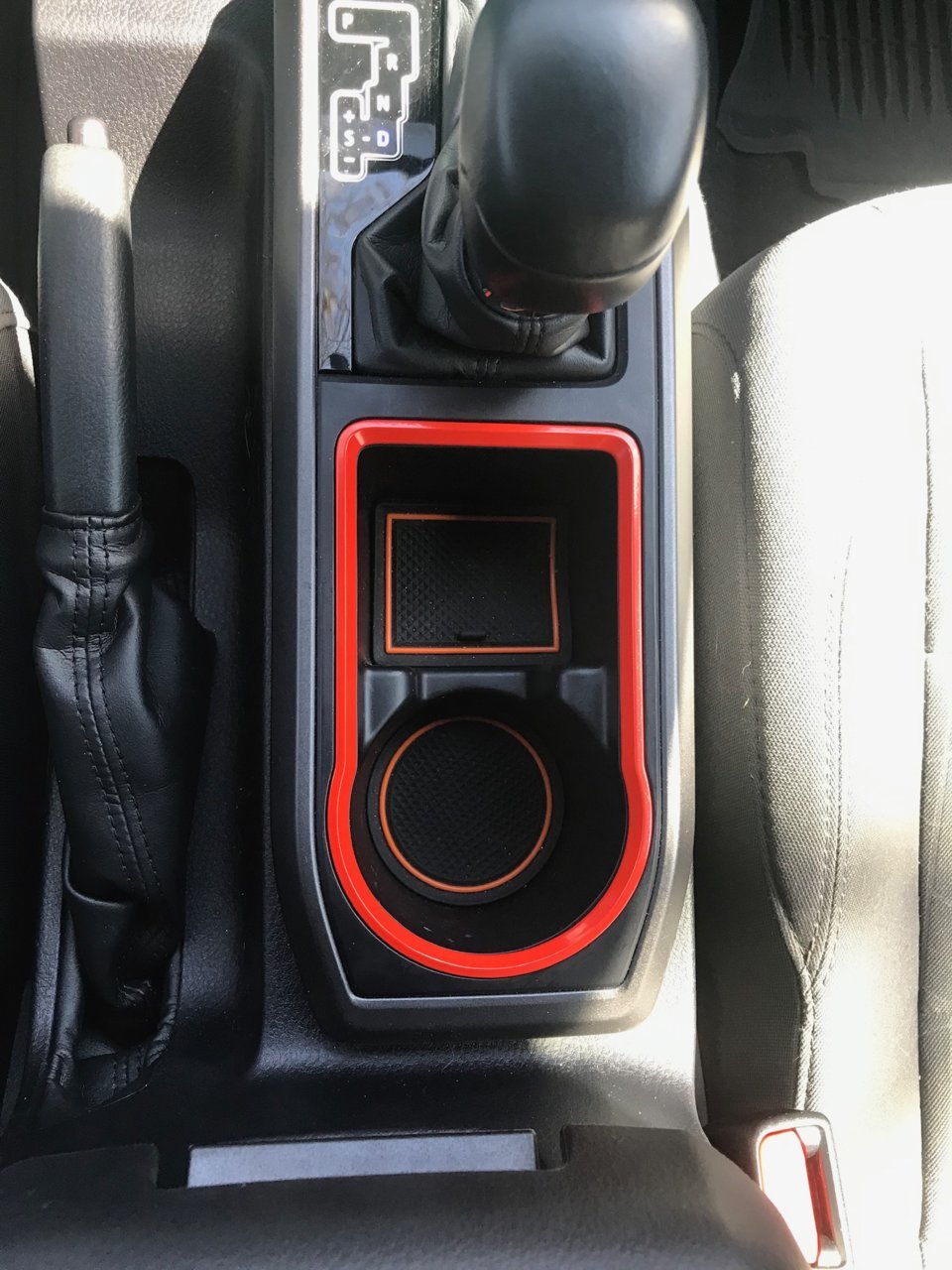

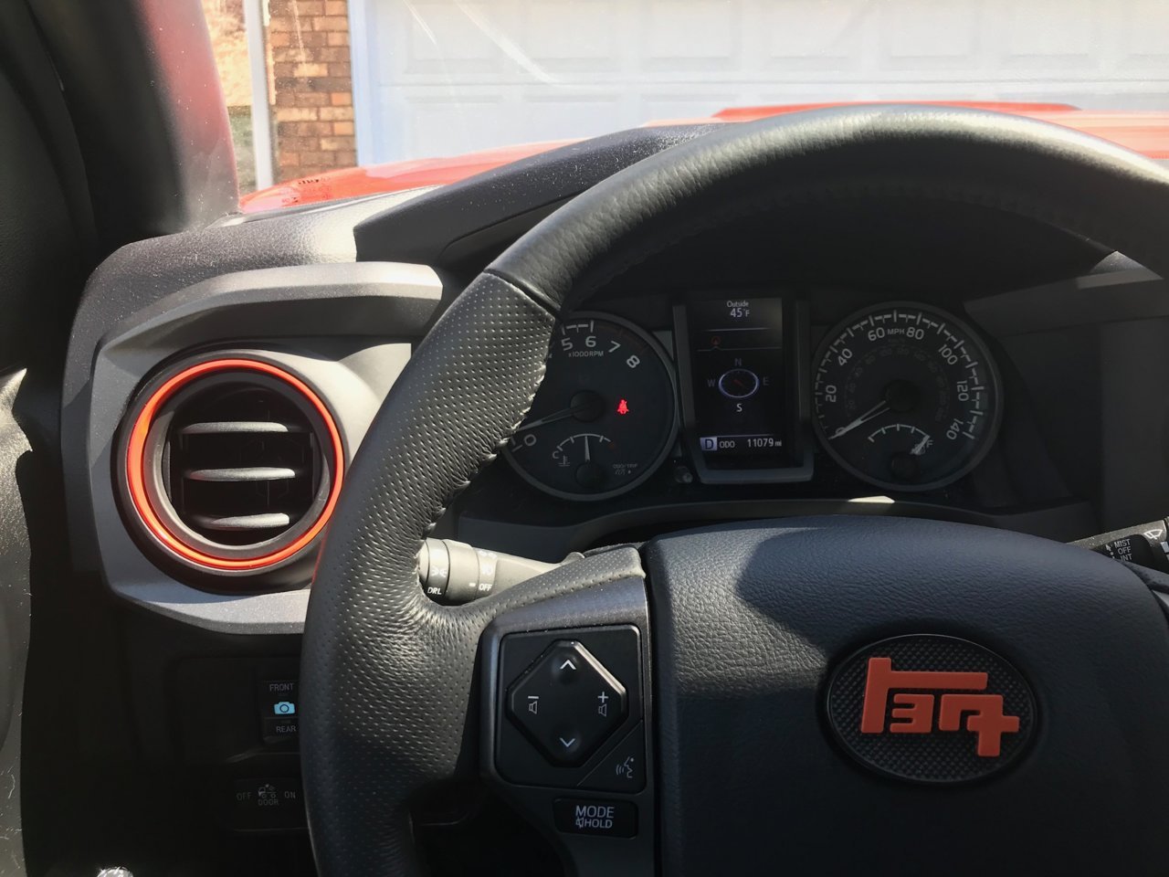

    Got rid of some chrome, probably more on the weekend.
