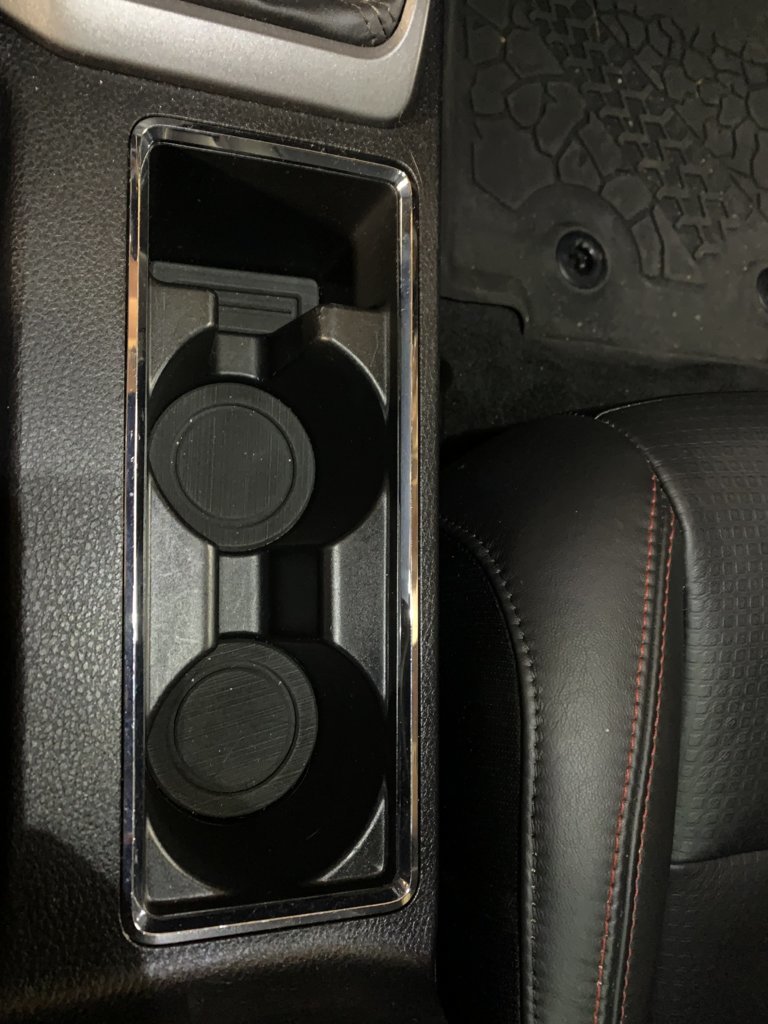

    I have managed to remove or cover all the shiny chrome bits in my '22 TRD Pro except for the cup holder surround. Yes I know who cares? I care and I just did not like all the chrome trim. So all I have left is this rectangular trim around the cupholders behind the (manual) shifter. It seems neither Meso nor AJT makes a replacement.
    Any ideas on how to cover/remove/paint this final piece of chrome trim?

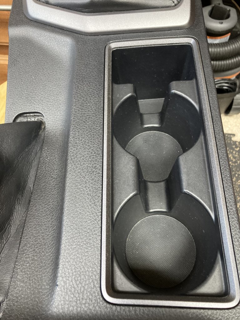

    Here's what I did on mine--
    -- Pried out the trim piece (it comes out straight up).
    -- Soaked it in strong bleach for about 2 weeks. The chrome flakes off and then the copper substrate. You are left with the black plastic. If you like the black then just leave it.
    -- I painted mine with Dupli-Color MGM.
    zanman5[OP] likes this.
