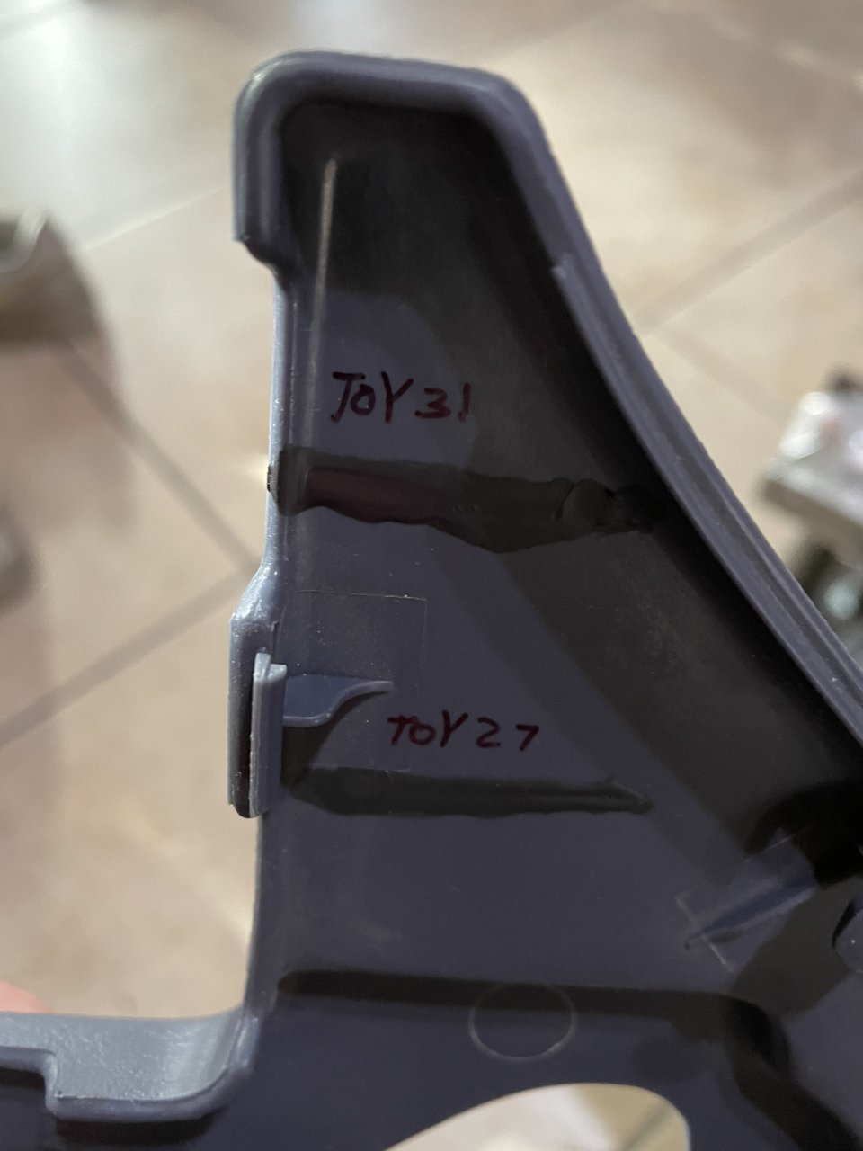

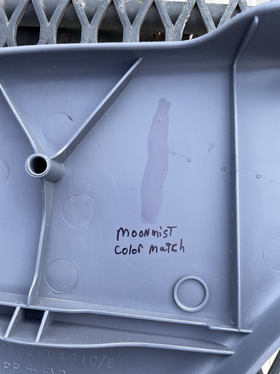

    I found a company that makes the interior dye’s. They told me that you can color the plastic with the dye using their products (the one for plastic isn’t listed on their site, you have to email them). This company is https://autoleatherdye.com/pages/toyota-dye-color-chart. This link takes you to all of the colors they have for Toyota. I ordered Moon mist and it will be here on Feb 4th. I spent $139 and will be able to do my dash, center console and have a few spare ounces. According to them you can color anything in your interior, leather, fabrics, plastic, carpets etc.
    *edit for information *
    The Moon Mist color they have (TOY31) is too dark. Ordered an 8of bottle of the light Moon Mist (TOY27) and will test it out. I will add my findings to this post.
    *second edit for information *
    The light moon mist (TOY27) is still too dark. I sent off an email and they say they can color match. I have a brand new still in plastic seat hardware cover that I will send in. I will see how that goes and edit again.
    *3rd edit for information
    They color matched the piece I sent them and it is extremely close. They labeled the bottles they sent “Moonmist”. I ran a test strip on another brand new part I had and am happy with it. I am following up with pictures of all 3 of the test strips I had done with the different colors. I will do a full part and post a picture

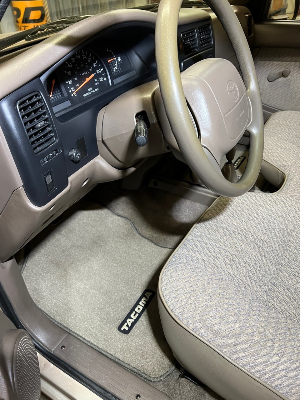

    '96 Oak interior and Oak floormats:
