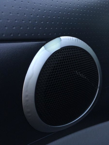

    So lately I've noticed there's a large amount of condensation on the inside of all 8 (includes sliding back glass) windows on my 14 DC. It's extremely annoying since the truck isn't even a year old yet (January). I literally just drove for 20 minutes with defrost on with temp in the middle then ran heat on full blast upper and lower vents, had to wipe all windows with paper towels. Now I'm noticing my driver side, only driver side, tweeter speaker shroud paint is bubbling and I just pulled some off because it was flaked ImageUploadedByTapatalk1414673038.617696.jpg
    Should I bring this in? It seems extremely severe from everything else I've been reading.
