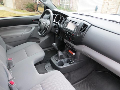

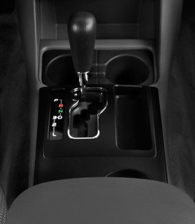

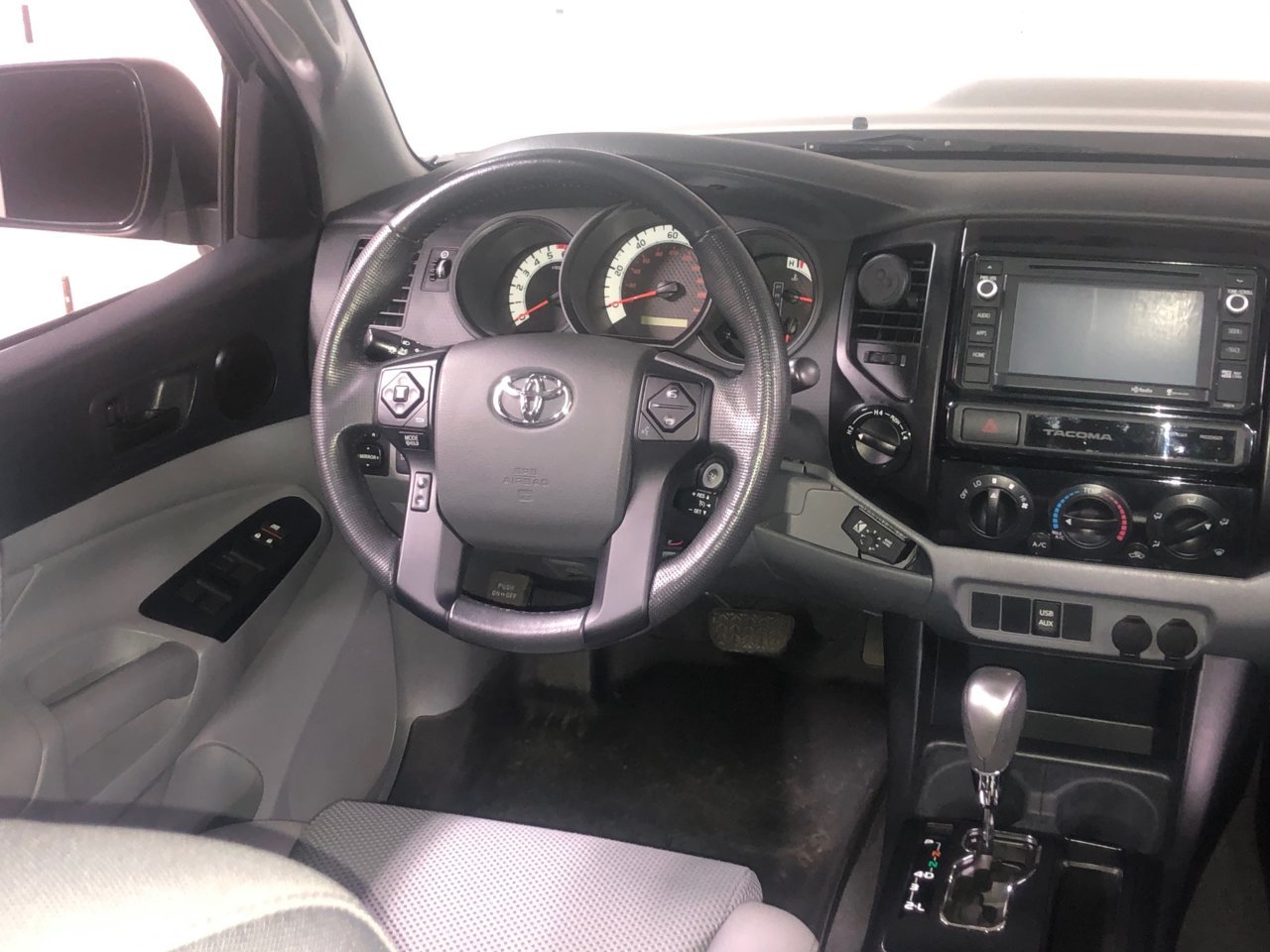

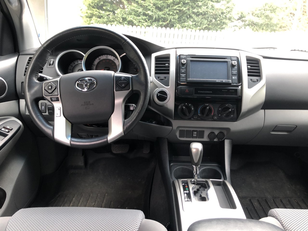

    I have a 2015 Tacoma withe silver trim air vents and silver around the shifter. Ive seen black ones like in these photos. Ive seen some people have them and that an old inactive account used to make them, I do not want to paint or wrap them. any help would be much appreciated

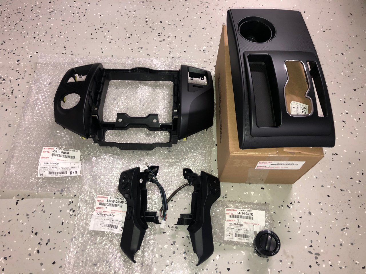

    Here are the parts I used on my 2015:
    55412-04090 Center radio A/C trim, black
    58805-AD010 Gear shift trim, black
    84250-04040-CO Steering wheel trim, black
    84724-04030 4WD switch, black
    Parts:

    Before gauge and tweeter rings
    After DIY rings (Unable to locate black rings to purchase, and DIY was as easy as people say...)
