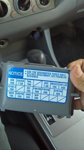

    Did anyone ever figure out which fuse it is?
    Edit: the dome light fuse is under the hood and it's a 7.5 labeled Dome

    Hey guys I was in the middle of installing my leds. I have the dome and two vanity light on. And as I pulled out the reading lights I noticed that all of my interior lights went out. I'm not sure what the problem could be? Any of you guys have any idea? Maybe a fuse?

    Check the fuse under the hood labelled dome. I just did this monday

    yeah fuse blew on mine when I tried the install. Just got a new one from AutoZone and going to try again this afternoon. So the best tips I've been told is don't push too hard when installing. Anything else?

    Lmk how your install goes. And your getting the 7.5 fuse right?

    yes I got the 7.5. AutoZone didn't have a single pack of the small version we need so I had to spend $5 on a multipack that had one single 7.5 and a bunch of others. Fingers crossed it doesn't happen again
