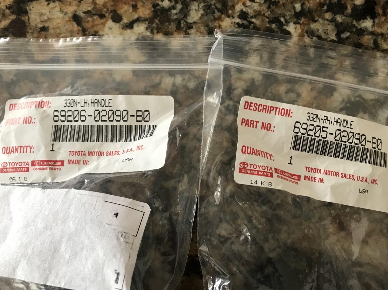

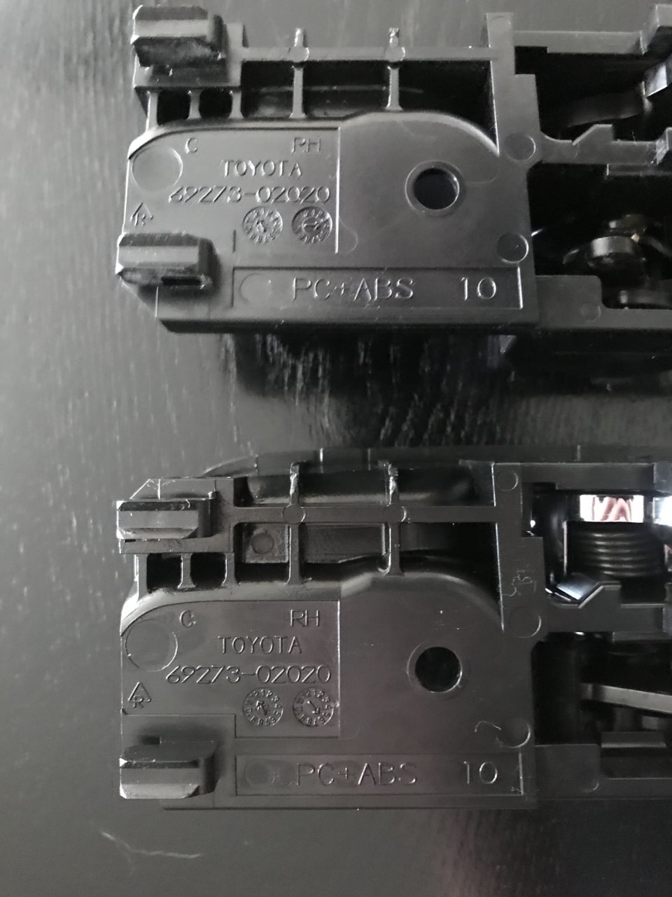

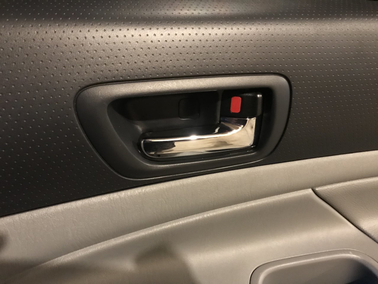

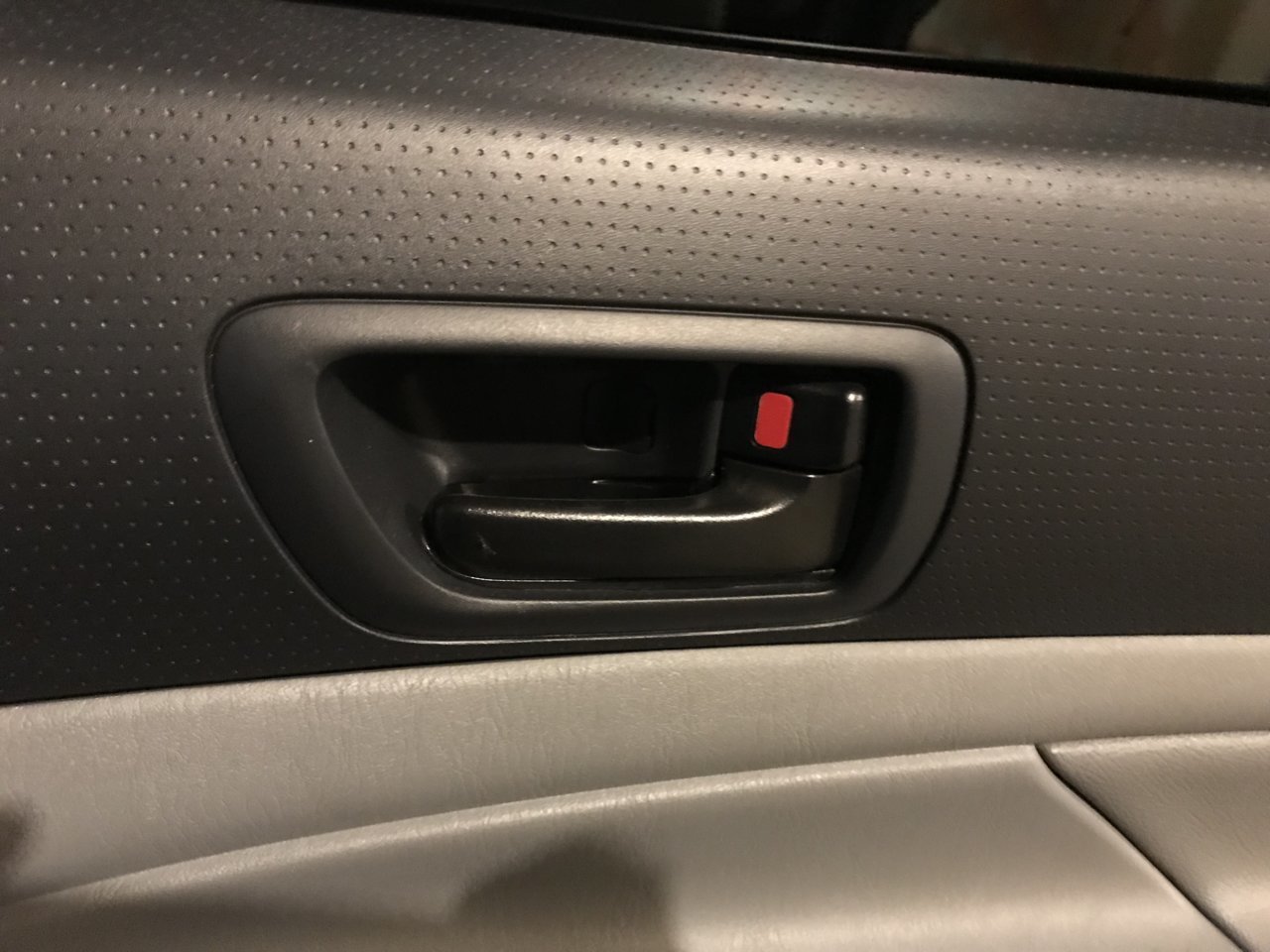

    Hey just wanted to post a fun little mod I did by working with used cars and noticing a lot of Toyota models had similar looking interior parts including the door handles, just thinking how to do small little dress ups on my interior and wondered if I could do chrome interior handles, started looking and saw that Scion TC handles looks super similar in shape, took a gamble and bought some and was glad to see that the door handles were in fact the same even having identical part numbers on the back of the handles. Installed flawlessly and happy with the results!! These handles come from 03-08 Toyota Corolla, 03-08 Matrix, and 05-10 Scion TC. And the front and rear door handles are the same so you would need two rights and two lefts :p so just in case someone else out there likes chrome like me or are in a pinch and can’t get Tacoma door handles, now you know that there are other options out there ;)
