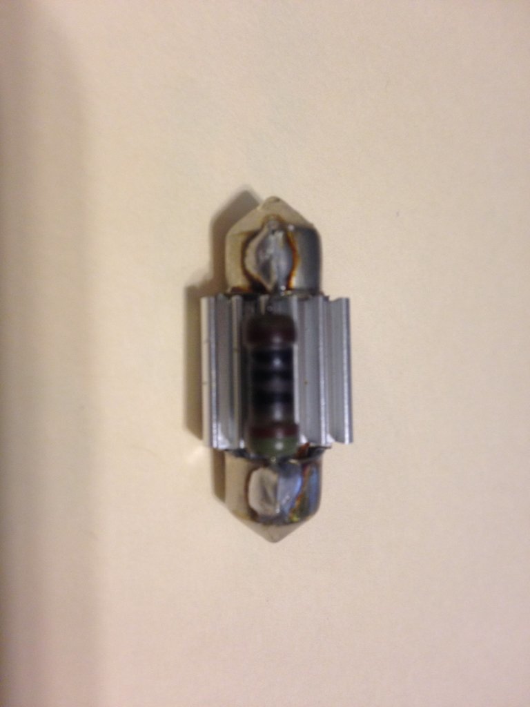

    UPDATE: I soldered a 100 ohm, 1W resister to both sides of the led bulb that I used for my dome light and it works!!

    I dont suppose anyone has found away around soldering resistor to the bulb yet? I was hoping there was a a relay or something that could get it done

    you will always need the resistor, as it is looking for a certain amount of current/amps(?) across the wire. I bought bulbs with the resistor already soldered, saved me from having to care ;p

    be careful with the 1 watt resistor. 100 ohms at 12 volts is .12 amps and 1.44 watts
    at 13.4 volts it .134 amps and 1.7956 watts.
    still gonna be less heat than the stock bulb, but the stock bulb was made to handle the heat, a 1 watt resistor is not designed to handle almost 2 watts of heat.
