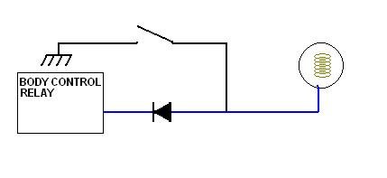

    I would expect that because the relay is designed for a constant voltage... the computer is ramping the current.
    It shouldn't be too difficult to come up with a circuit that could "read" the signal and trigger a relay with that... you just need to filter it and regulate it to hold a steady level until a cap discharges then it dumps.
    But the OP is wanting to go the other way.
    You could theoretically ground directly to the wire from the light... and to protect the computer, just put a diode in series with the computer.
    Perhaps a safer way to go would be to trigger at the door switch, but that's not going to provide an instant-on/off... it's going to fade off.
    Not too good when you just want to hit it so your passenger can read a map or fish something out of her purse.
    This circuit will turn the light on without impacting the computer and drawing no additional current through it.

    Your diagram looks like it would work for what the OP is trying to do.
    In my case I was trying to make the added lights in my camper shell come on with the factory dome light when unlocking the doors using my factory keyless system. The wire involved is so small I was afraid to add any load to it.
  6. Sep 22, 2012 at 5:59 PM

    Agreed for your application.
    You do need to drive a relay, and to trigger it with something with a hard cutoff rather than allowing the computer to ramp the level down.

    In theory, you could trigger from the door pin switches, or from the diagram I posted, but I don't know how the Matrix switch is wired. It may or may not have a simple make-break contact.
