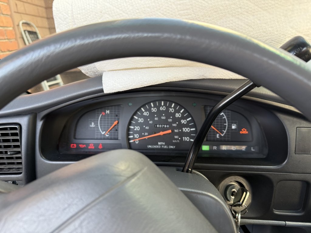

    My 97 has never had the low gas light turn on no matter how low it gets . All main dash cluster lights are not working (Speedo,heat gauge ext ) warning lights at the bottom still work . Also lights for center heat defrost ext turn on and off turn on when I bang the dash but now seen to never turn on . I checked fuses to the left of steering wheel everythings good. Looking for advice before I start to disassemble entire dash .

    I assume the 10A Gauges fuse is good?
    With the key on, Engine OFF
    Do you have a parking brake light on when you press the E-brake?
    Is there an oil pressure light?
    Seat belt Light?
    Does the Check Engine Light come (remember engine OFF, but key full on)

    Battery, oil ,E brake ,seatbelt ,check engine ,and what gear it’s in light up just no light from all 3 main cluster gauges, and no light for heat and air center dash trying to upload pictures

    Vlintorez Thanks bro my 03 definitely has it but my 97 has absolutely no options so it would make since that it doesn’t have a gas light in the first place .
    Glamisman Absolutely dash is already halfway disassembled from installing new stereo. I’m thinking spray connector with detox ?

    2000 Tacoma 4WD Base - no low gas warning light but it has AC!
    I have a 2000 and it did not come with a low fuel light but I have a tach. Oddly it does have a low washer fluid light, because priorities.

    It's less Tacoma and more mod
    It probably doesn't have one, that truck in the picture is super base model, doesn't even have a clock haha. My 96 LX 4x4 doesn't have a low fuel indicator or the required sensor in the tank either
