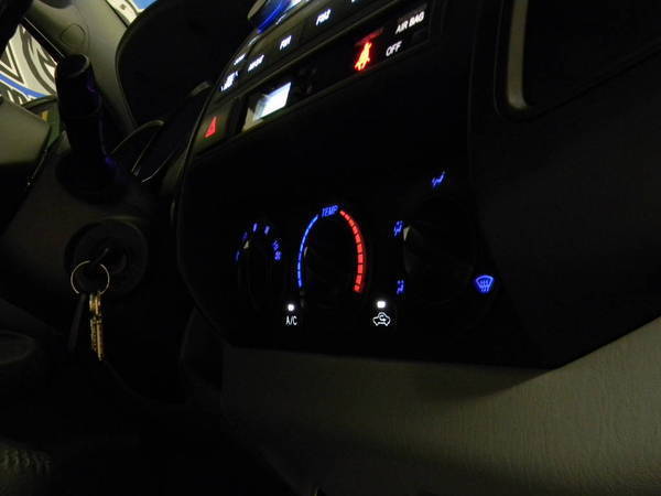

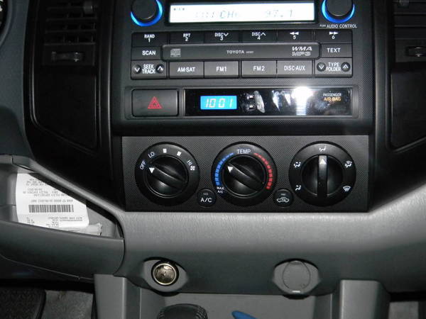

    In my goal of changing everything on the dash to black from silver and the lights from amber to white and blue.
    Dash gauges and radio were pretty fun to change the leds out compared to the temperature controls.
    So I took everything I came across on the forms and some ideas I had on changing the A/C control dial's colors and came out with this:
    [​IMG] [​IMG]
    [​IMG] [​IMG]

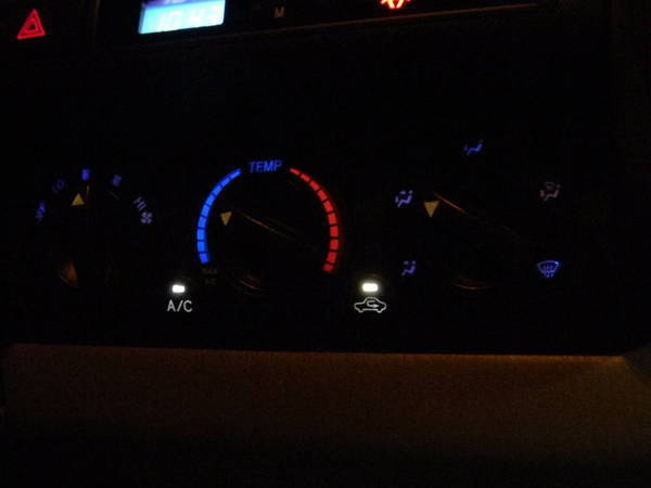

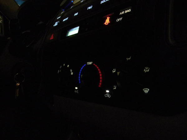

    The short story on getting it done. Sanded all the amber off on the dials. I took little cut outs of all the images on the dials to paint white and cover everything else up, to block the light out. Then photoshoped a picture of the dials, changed the background from silver to black and cut out the images to print as white. Printed it on clear vinyl and then installed. The blue is from blue tape in the back of the dials. Same thing for the A/C and circulation button, printed on clear vinyl. This is probably going to lose you if you have not seen the guts of the dials. I am still not happy with the uneven light display from the LEDs I put in for the dials, but they are a clearer white than the bulbs that are normally in there.
    3-6-11
    pulled the blue tape from behind the icons and left white

    I ordered the vinyl online and printed it with my inkjet printer on the photo setting. I sprayed it with regular old flat/matte clear in a spray can for the finish.

    Some by accident but mainly a hazard of taking out the amber. It has to be smooth for the sanding not to show through when putting the vinyl back on in the end. I printed the dials in black on the vinyl to black out my entire dash, and I thought that would be the best way to block out the light from behind. It also matches my radio. I am not sure if my printer would print out in silver very well. Maybe a better printer or print shop could print in silver and the background could be done in blue.
