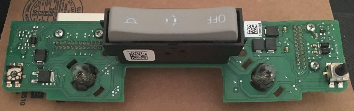

    Ok so this might sound stupid but the rear dome light, it should come on by itself right? When the rocker switch up front is turned on the map lights and dome light come on, when it's set to door they all come on when the doors open, but if that rocker switch is set to off and I try to turn on the rear dome light it won't come on, same if I try to only have the rear dome light come on when the doors open. I think something must be wrong, if the rear dome light cannot be turned on separately then why does it have a switch on it?

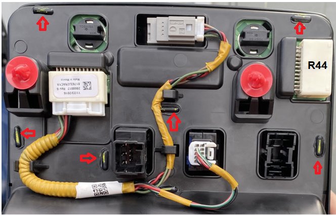

    It's held in by the console and also a part of a circuit-board. Not an easy removal.
