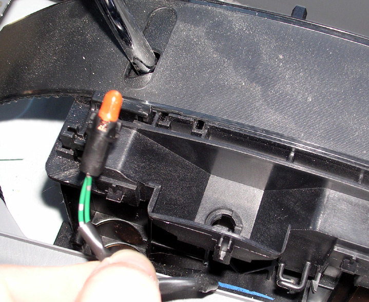

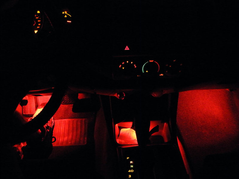

    I'd assume there are a few spots you could choose from. In my 2005 tacoma, I spliced into the light by the gear shifter. That made the footwell lights come on whenever regular lights were on (parking/headlights). Those pictures are attached.
    If you want a switch for it unrelated to your other lights, you could likely splice into the 12v plug. Both of these keep the length of wire needed short since it's all right in the center area for you.
